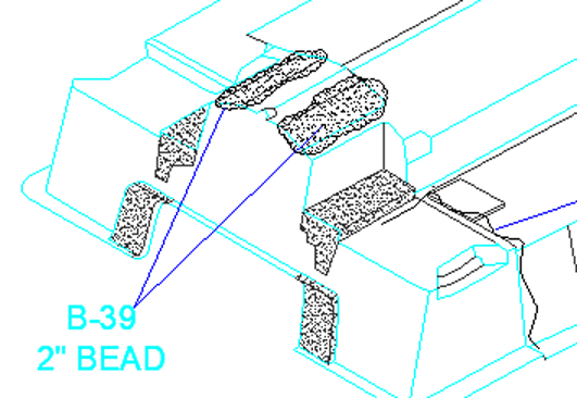

Peter inquired with Boston Whaler regarding the location of a putty box. He received the following reply and attachements which he sent to me. I have extracted the image files and the text, which I reproduce below:
BostonWhalerCustomerServiceRepresentative wrote:...while we no longer use putty boxes...the area you are looking at should be solid. [Figure 3 below shows] a layer of putty that is applied to the boat before we close the molds...
Fig. 3. View of the underside of the liner molded part showing where putty is applied.
BostonWhalerCustomerServiceRepresentative wrote:...and [Figure 4 below] shows the location of the [PENSKE] board. [PENSKE] board is not wood or phenolic, but a rigid fiber reinforced compressed foam. You should be good to install a thru hull in this location. Just note that if this is not done at a Boston whaler dealer, you will void your 10-year-hull warranty.
Fig. 4. View of the inside of the hull molded part showing where reinforcement material is applied.
