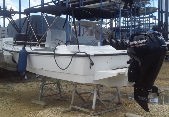

Fig. 1. The modified RAGE 15 seen from the port stern quarter.

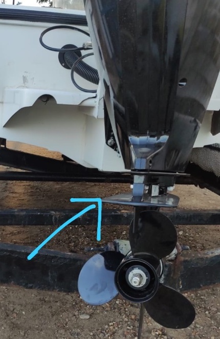

Fig. 2. The anti ventilation plate is about 1-inch below the lowest part of the hull—that’s not good.

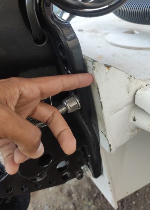

Fig. 3. The remaining vertical distance the engine could be raised.

When you attached the new stern bracket to the hull of the RAGE boat, its vertical position on the transom created the nominal transom height. The result looks like about a 15-inch transom height.
By mounting an engine with a 20-inch shaft onto the stern bracket, the result is the engine is mounted too low—maybe as much as 5-inches too low.
The stern bracket you have used appears to have a buoyancy box, but because the bottom of the stern bracket will never get out of the water, the buoyancy box is adding drag. Also, in Figure 3 there appears to be a flange at the aft end of the bracket that is getting dragged through the water, and that is creating more drag.
I suspect that changing the vertical position of the attachment of the stern bracket to the transom is going to be very difficult. Then the only option will be to raise the engine as high as you can with the five-mounting-hole sets.

Jim beat me to this, but the engine is buried in the water and you will not achieve a decent ride with the current setup. Porpoising is a common outcome for boats dragging too much lower unit in the water.
Generally speaking, shorter boats don't respond as well to brackets due to the weight of the motor being moved beyond the stern causing the stern to "hog" down in the water. Manufacturers typcially offer brackets on boats of 20-feet or longer, and they also account for this setback by raising the bracket on the transom so the motor sits higher.
The only options I see available are:
—switch to a 15-inch-shaft motor.
—raise the stern bracket on the transom to achieve the desired amount of lower unit in the water while on plane.
While on plane you should be able to see the top of the anti-ventilation plate The downside to raising the bracket is the wetted area of the buoyancy box is reduced and the boat will sit lower in the water due to weight being carried further off the stern.
The weight of that Mercury FOURSTROKE is already heavy for that boat at 360-lbs dry, so rigged and set you are approaching 480-lbs. I can't image that much weight on a bracketed boat that short.
Another option would be a lighter engine , a two-stroke Yamaha is only 225-lbs and the F70 Yamana is 255-lbs. Removing 100-lbs hanging off the boat that far back would make a difference in additional to options above.
