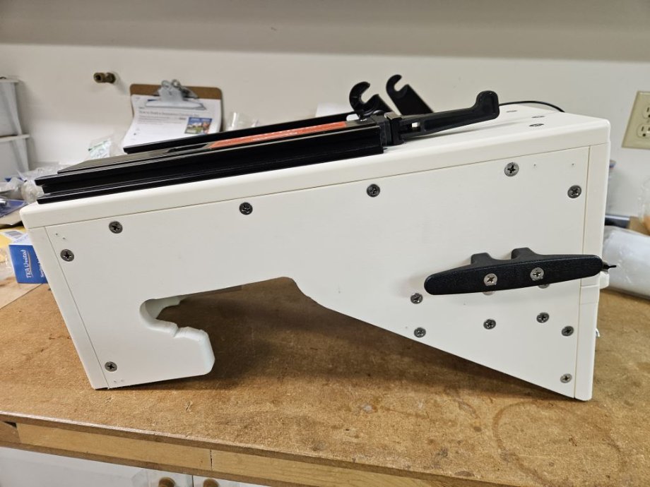

Fig. 5. The finished mockup for my 1988 Super Sport 15.
Fig. 6. The mockup now partially disassembled to serve as a template for the final mount. I used 3/4-inch KING StarBoard for the this mount as it will result in a maintenance-free mount and will reduce the potential for hull abrasion caused by mount. The KING StarBoard was covered with blue masking tape to protect its surface and to permit layout lines to be clearly visible when cutting and drilling.
Fig. 7. Checking the partially constructed mount for fit.
Fig. 8. Once in place, lines were marked for the location of the upper runners for the key as well as for the slots within the runners to permit the norman pin to pass through them.
Fig. 9.The underside of the mount showing the runners for the key.
Fig. 10. The mount is designed to grab the lip of the bow forward of the navigation light, rotate over the navigation light, and then over the norman pin must pass through the notches within the runner for the key. Note the relatively tight tolerances between the base of the navigation light and the internal sides of the mount. Similarly, the width between the notches is only slightly larger than the width of the norman pin. These tight tolerances are designed to minimize the lash within the mount when fully installed.
Fig. 11. The norman pin must pass through the notches within the runners for the key. As shown within this photo, the mount must rotate a bit further until the lower surfaces of the norman pin are above or at the same plane as the upper key runner's lower surface. The width between the notches is only slightly larger than the width of the norman pin. These tight tolerances are designed to minimize the lash within the mount when fully installed. This photo was taken through the slot for key.
Fig. 12. The norman pin must pass through the notches within the runners for the key. As shown within this photo, the lower surfaces of the norman pin are above or at the same plane as the upper key runner's lower surface, permitting the key to be inserted. The width between the notches is only slightly larger than the width of the norman pin. These tight tolerances are designed to minimize the lash within the mount when fully installed. This photo was taken through the slot for key.
Fig. 13. Completed mount positioned on boat.
Fig. 14. Mount in position and is ready for the key to be fully inserted.
Fig. 15. Key fully inserted and locked into place with stainless steel turn buttons.
Fig. 16. The electric trolling motor locked to the Minn Kota Quick Release Mount.
Fig. 17. The trolling motor deployed.

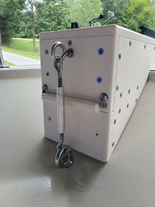

Postby Schuyler84 » Wed Sep 01, 2021 7:32 am
After receiving some feedback, I have altered the design of my mount to include an additional means of securing its aft end to the hull. This has been easily accomplished by installing a 3/8-inch stainless steel eye within the mount's upper aft panel.
A 3/8-inch stainless steel turnbuckle will then be used to connect the eye nut of the bow eye to the aforementioned 3/8-inch eye bolt. The additional security measure should greatly reduce the risk of shearing the norman pin when operating in rough conditions.
Should the mount's locking key have interfered with the turnbuckle, then the aft edge of the locking key would have been notched to provide the necessary clearance for the turnbuckle to be tightened or loosened. Ultimately, this modification to the locking key proved unnecessary. The turnbuckle also provides additional protection against the mount's locking key inadvertently backing out.
Is the turnbuckle excessive? Perhaps, but this addition is cheap insurance against loosing the almost $1,900 trolling motor, Minn Kota mount, and the fabricated mount over the bow.
Fig. 18. Steel turnbuckle holds the mount in place.

Cleat Added: While I have not yet needed to deploy an anchor when using the trolling motor (which has anchor mode), the ability to deploy and tie off an anchor is should be considered a must have safety feature. As the trolling motor mount covers the boat's bow norman pin, use of the trolling motor mount would have prevented easily anchoring from the bow. This limitation was recently resolved by fastening a 6" cleat to the port side of the trolling motor mount.
Fig. 19. A horn cleat fastened to the side of the mount to replace the now covered Norman Pin for fixing a mooring line or an anchor rode.

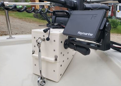

Earlier within this thread, I discussed that a RAM electronics mount is currently fastened to the starboard side of the trolling motor mount to hold a marine electronics multifunction display.
Fig. 20. A gimbal mount for holding a multi-function display.
