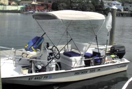

[To mount the frame of a bimini top on a 15-foot classic hull,] I used the side rails.
The Bimini top frame was stainless steel, and it came from another boat so some bending was necessary.
The top fabric was Sunbrella.
[The Bimini top] folds down and lays flat at the stern [of the classic 15-footer]
[The Bimini top frame] is clamped to the side rails with stainless Bimini mount hardware.
[On my classic 15-footer there are] two stern seats that the backs rest against the folded Bimini top rails.
The Bimini top out of sight when folded down.
Fig. 1. Bimini top on 15-footer with frame collapsed and top folded.
FIg. 2. Erected BImini Top on 15-footer

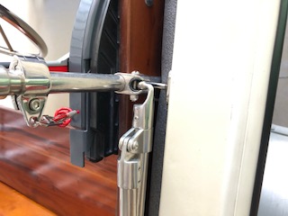

A few years ago I purchased a Bimini top for my 1985 15 Sport. I was reluctant to drill into the gunwale so I searched online and found these fittings.
Fig, 3. Bimini mount on side rail
I replaced the pin that held the ball with a machined screw. So far, it has held up well.

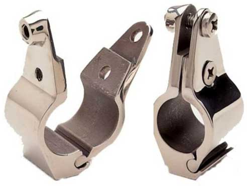

Fig. 4. A typical rail-mount Bimini top frame hinge fitting made by TaylorMade.
The TaylorMade rail-mount frame hinge fitting can be bought from Wholesale Marine for about $63 a pair:
https://www.wholesalemarine.com/bimini-canopy-top-rail-mount-hinge.html

Just the fact that [the hinge for the frame of a Bimini top] will be rail mounted negates the idea that [the Bimini to[ will lay down [outboard of] the rails. The Bimini top MUST lay atop the rails.
The Bimini top will then act as a barrier to access the stern.
I don't mind [the added five inches of height due to stacked railings when the Bimini top is folded down]; the added railing height makes the sides more secure for the children--but it may irritate you.
I use some pool noodles to cushion the [original boat railing] from the Bimini top rails [to suppress] rattling.
But please measure, measure, measure to get it right the first time.

I purchased from vortexdirect.com. It was important to me to have a stainless steel frame. The top is nice but may not be the same quality as a Mills' Flying Top.
I don’t remember where I got the fittings; I suggest a search for "ball mount bimini hardware."

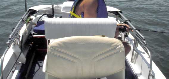

Postby Oldslowandugly » Mon Dec 06, 2021 6:01 pm
[The frame railings for the Bimini top on my boat that are mounted to a hinge on the original boat railings] lay flat on the side rails.
Fig.5. Added rails for Bimini top lay flat atop the original hull rails. For an additional view refer to Figure 1, above.
[Regarding the choice of fore-and-aft location for the hinge] the Bimini top wrapped in the boot [when folded down] lays [aft of] the [custom made and added] stern seats [on this particular boat]. Also, the engine when tilted up does not hit the top. The top is as out-of-the-way as it can be.

Postby TFrere » Mon Dec 06, 2021 6:13 pm
My bimini lies flat on the gunwales of the boat with the ball and socket fittings.

If there is a strong preference to locate the hinge fitting for the frame rails of a Bimini top on the the side rails of a classic 15-foot Boston Whaler boat, there is really no impediment for accomplishing that.
The rail-mounted hinge fittings seen above in Figure 4 will result in the frame railings piling atop of boat's side railings when the top is in the stowed down position, as has already been explained and illustrated several times.
The unusual ball-and-socket hinge fitting seen in Figure 3 which is mounted to a vertical stanchion post for the boat's side railings will result in the frame railings resting outboard of the boat's side railings. However, the choice of fore-and-aft location will then be limited to the location of the vertical stanchion posts for the boat's side railing. Whether or not there is a vertical stanchion post in the boat's side railings that will produce the desired location for the folded-down top will depend entirely on the height of the top and its longest railing.
A further consideration is whether the height of the top should be chosen for the best fit when the top is deployed as sun shade, or whether the height of the top should be chosen to make it fit best when using the pre-determined attachment point of a vertical stanchion post for the existing side railing.
In my experience, if a boat has a Bimini top, the top is generally almost always deployed when the boat is in use. To alter the dimension of the top to enhance its fit (due to use of a fixed mounting point) when stowed seems inappropriate.
