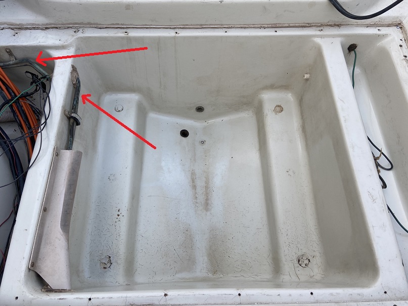

I have a question on the fuel hoses/pipes...
On the pic attached, the live bait well. The left of the pic is the fuel tank compartment. Top of pic is the drain sum. The arrow is pointing to the little brass (or copper?) fuel pipes. There were 2 x 5/8 hoses running from the gas tank through the wall (on left of pic) and clamped to the 2 little copper/brass pipes behind the brown plastic cover. As you can see, the copper pipes go through the wall and come out on the drain sum. Then they come up on the far top.
My question is should I keep using the same configuration with the little copper/brass pipes or should I run the hoses from gas tank all the way out? Any pro and con?
Thanks in advance.
Thanks in advance.
- Small_Brass_Fuel_Pipes.jpg (147.55 KiB) Viewed 7332 times

Re: Re-doing Fuel Hose Rigging on Twin Engine Boat
If there is no corrosion the original design should be sufficient. My concern is how are the tubes sealed in the wall between the Fish Box/Well and the Drain sump? That pass through needs to be sealed well so water doesn't get around the tubes and into your foam core.
Hi Vance,
If I use the same 2 little brass/copper tubes, I plan on using 1" fiberglass tube and marine-tex it there, the way you did your through hull tube. It will seal the water not to come into the wood/foam, but letting water go between the drain sum and the live well.
If it is better to use 5/8 fuel hoses, I will have 2 x 1" fiberglass tubes there instead of 1. Each for each hose.
What do you think?
