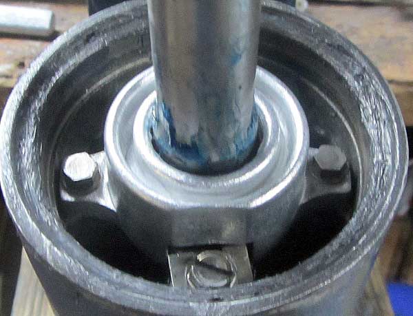

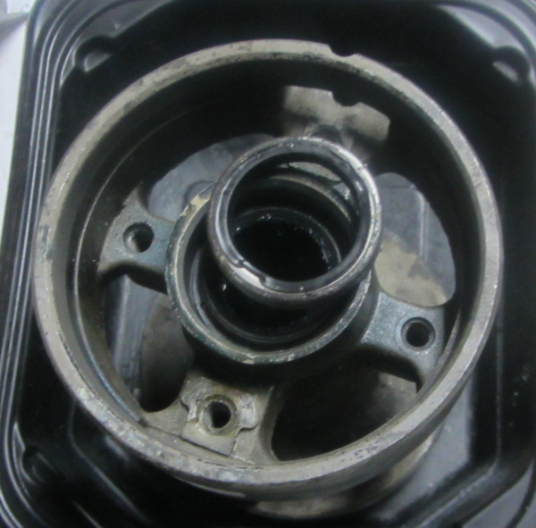

I am re-building my 1996 Evinrude 48SPL gearcase. The propeller shaft bearing carrier has seals at the outer end.
A double-lipped seal
A single-lip seal
I found that use of two single-lipped seals (that used to be installed back to back) has been superseded by one double-lipped seal.
I was able to install the new type seal deeper into the seal cavity. That gave the the seal surfaces fresh metal to ride on. There is room to add another of the original single-lipped seals on top of the new double-lipped seals. At surfaces of a new seal would ride at the outermost part of the seal cavity and still be on the correct part of the propeller shaft.
Fig. 48. A new double-lipped seal has been installed. There is room for another single-lipped seal.
Is an extra seal beneficial or detrimental to the other seals?

What lubricates the seal-to-shaft interface as the shaft spins?
For the inner seal would imagine gear oil be the lubricant?
For the outer seal would water be the lubricant?
Oldslowandugly
Posts: 719
Location: Queens NY
Re: Add Extra Propeller Shaft Seal
Postby Oldslowandugly » Sat Jan 22, 2022 8:57 am
For the outer seal would the lubricant is water. The pressure of the fluid seawater would press the seal lip against the shaft. I read that the open side of the seal faces the seawater for this reason, however, I am no expert at seal operation.
The factory service manual instructs for the installation of two separate seals in the original design, and to pack the space between the two seals with OMC Triple Guard grease
The outermost seal would take the brunt of the force trying to push water into the gear case. Any water that intruded past the outer seal would encounter the grease and then the second seal.
Someone suggested that since the inner seal would not see either oil or water then it may starve for lubrication. It would get hot, the grease would melt and leak away, and the non-lubricated seal would probably fail.

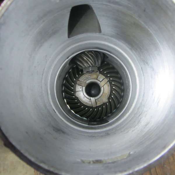

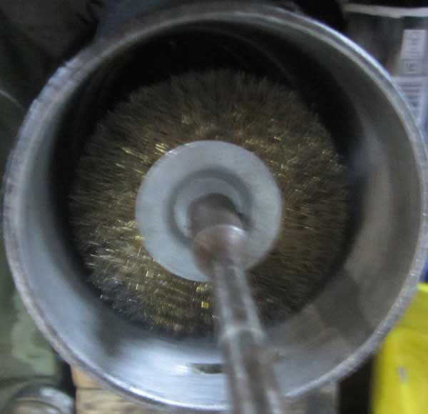

With the carrier seals in place and working I can finally place the carrier into the gearcase and seal it up. I removed the propshaft again to clean inside. I had to wirebrush the remains of the cured Ultra Black from the inside of the case. It comes off very easily by using a wire brush on a long shaft and an electric drill. Then flush out the debris with solvent.
Fig. 42. Wire brush on gear case (out of focus).
Figure 43 shows is the clean gearcase ready for the carrier. See the ledge inside? That is what makes it hard to get the O-ring part past it.
Fig. 43. A clean gearcase ready for assembly.

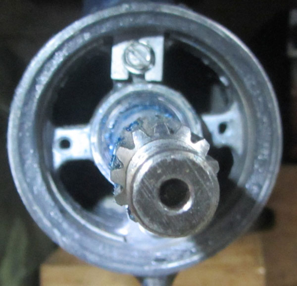

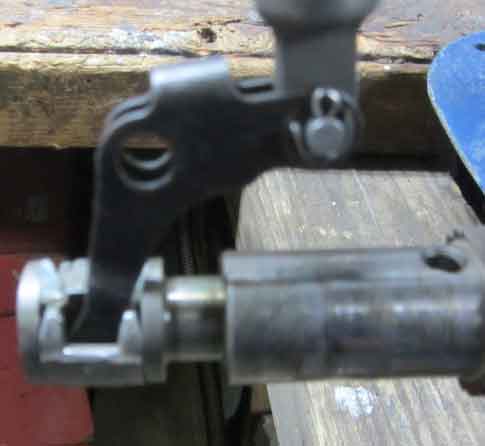

Don't try to insert the propshaft without removing the shifter rod. You will never get the shifter pivot fingers into the slots in the shifter cradle. Open the shifter rod seal carrier up top again. It is only sealed with Triple Guard grease so no harm done. Place the shifter cradle on the shifter dog end of the propshaft and retain with the OMC needle bearing grease. Insert the propshaft until the cradle just pokes through into the shifter cavity. Then you drop the shifter rod and pivot down to engage the slots in the cradle. You MUST look in with a flashlight to see what you are doing to get it right.
Fig. 44. The arrangement inside inside the gearcase. The pivot arms must engage the cradle slots. (Out of focus.)
Once that is done you insert the pivot screw through side of the case and through the holes in the pivot and tighten to the [undescribed] specified torque.
Use Lok-Tite on the screw threads, and use sealer on the screw shaft.
If you did it right you can shift the gears with the shifter rod and the propshaft can't be removed.
Then I placed the reverse gear and thrust bearing into the case. The thrust washer goes back on the inner carrier face. The thrust bearing and washer are held in place with the OMC needle bearing grease.
Now the carrier can be inserted. Again, I coated the O-ring, its groove, and both flanges with Ultra Black sealer to prevent leaks and corrosion.
As before, use the long extractor screws to grab the carrier and insert it with the drain hole at the bottom.
Then I used a length of PVC pipe and a woodworking clamp to drive the carrier all the way in. Two carrier retainers are installed and retainer screws tightened to [undescribed torque] specifications.
Now that the gear case is back together, I must wait 24 hours for the Ultra Black to cure. Then I can test for leaks.

Fig. 45. The gear case after reassembly.
The Ultra Black must be allowed to cure for 24-hours. I will give the Ultra Black a longer during time because of the large carrier flange surface I coated.
Do not pressurize the case for a test and blow out uncured sealer.
That would ruin all your work and require rebuilding it all over again.

Update: either the new double-lipped seal is not worthy or perhaps I failed at installing it. Either way, when tested it leaked air terribly. I removed it and purchased two new single-lipped seals. I installed them back-to-back as per the factory manual. When tested they held air nicely.

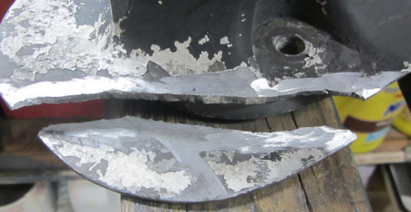

While waiting for the Ultra Black to cure I turned my attention to the parts gearcase.

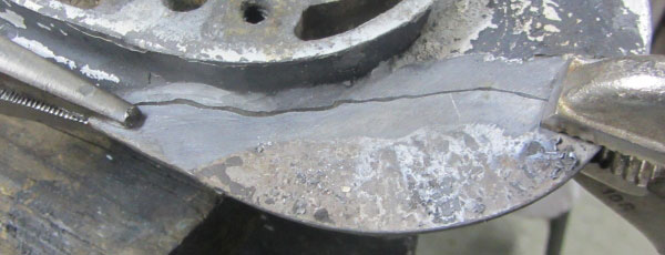

The front of the cavitation plate suffered a big bend and cracked on both sides. I wanted to try the aluminum brazing technique I see in videos. I took my grinder and cleaned off the area along the crack and found it was pretty bad. Just doing that made it break off completely.
Fig. 46. Touching the anti-ventilation plate with a grinder caused a portion of it to break off.
After cleaning the crack I clamped the broken piece to the plate.
Fig. 47. The broken segment was clamped in place for possible re-welding.
I tried to braze the two pieces of the anti-ventilation plate back together with some 4043 TIG rods. I found that a blowtorch was not sufficient to melt the TIG rod. Research showed the 4043 rod melted at around 1000-degrees-F, which is too hot for this technique. The correct aluminum welding rods [unspecified] for this application will melt at around 600 to 700-degrees-F.
You might be tempted to try an oxy-acetylene torch but that would surely melt the gearcase itself.
I will ask my welder friend to TIG weld this for me.

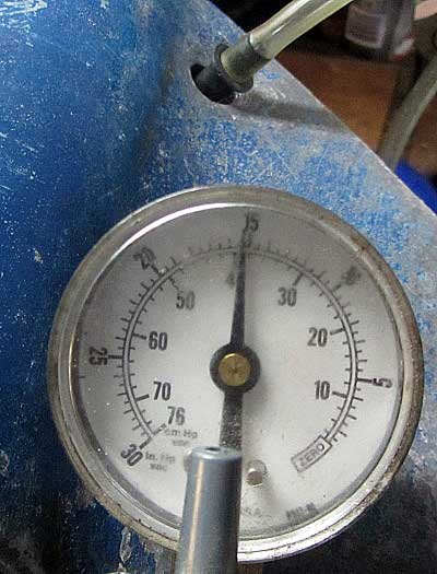

You must also test with a vacuum source such as a Mityvac tool. I used a Mityvac adapter to screw into the drain hole with a bit of OMC Roller Bearing grease to eliminate a leak at the drain hole threads.
Fig. 49. MityVac tool showing 15-inch vacuum.
First, create a vacuum of minus 3 to 5-inches; see if it holds. If yes, then increase the vacuum to 15-inches.
If the seals leak at either test, squirt oil around each seal to find the leak. Repair as necessary.
Gearcase seals held vacuum at 15 inches just fine.

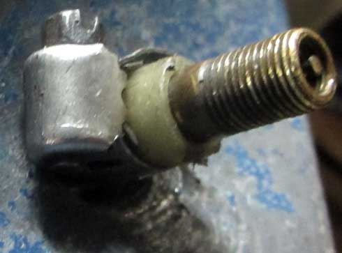

I used a home-made pressure tester that consists of a short length of plastic hose that is clamped onto the end of a regular tire schrader valve. I screw the plastic hose into the gearcase drain hole.
Fig. 50. Home-made pressure adaptor.

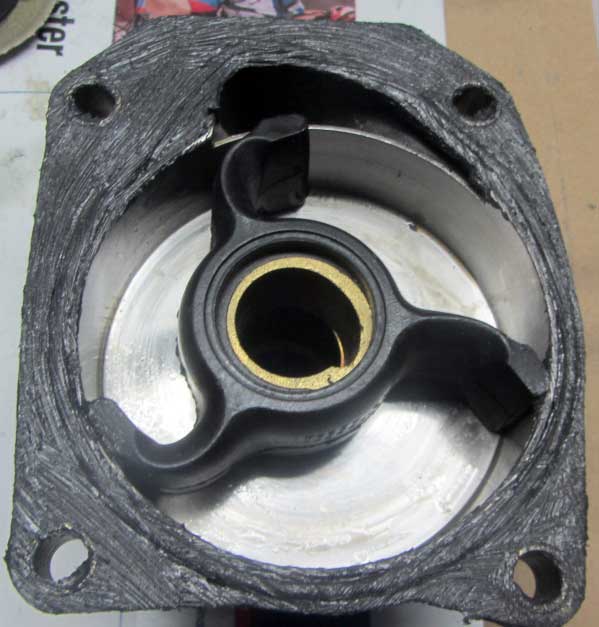

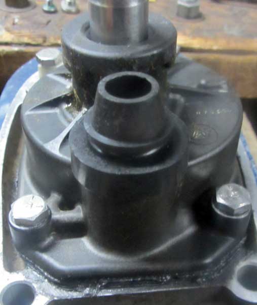

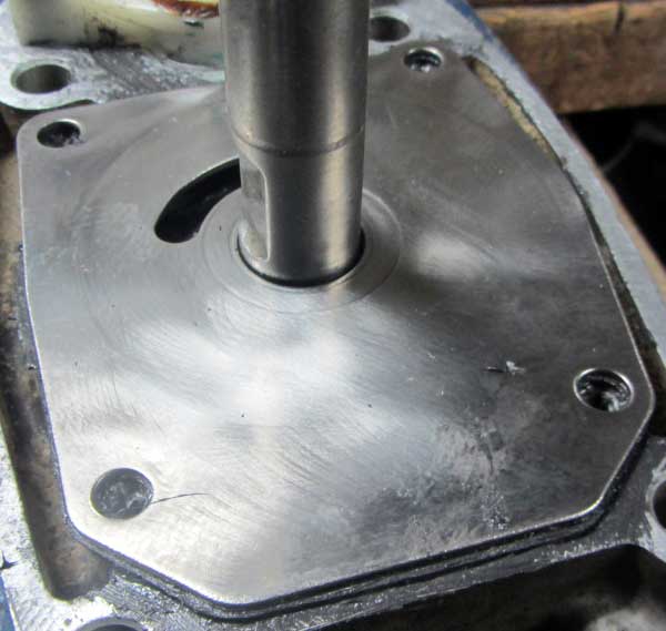

The water pump service used a a new impeller and new seals. The pump housing and plate were in perfect condition so I re-used those parts.
I use Ultra Black to seal a new gasket to the case and the impeller plate.
Fig. 51. Impeller plate and new gasket in place.
When inserting the impeller, oil the housing lightly and twist the impeller in counter-clockwise. The open side of the cam groove must face you. Make sure all three vanes are bent in the correct direction.
Add the driveshaft grommet to the top of the housing and seal with OMC Adhesive-M or 3M847.
The formed O-ring goes into the groove, and I seal it with some Ultra Black.
Fig. 52. Pump impeller and O-ring in place. Ultra Black sealer on housing face.
[MODERATOR'S NOTE: In Figure 52 the impeller looks like it was turned COUNTER-CLOCKWISE. Please clarify.] The answer is that you are looking at the impeller housing from the bottom. In the installed position it will be CLOCKWISE.

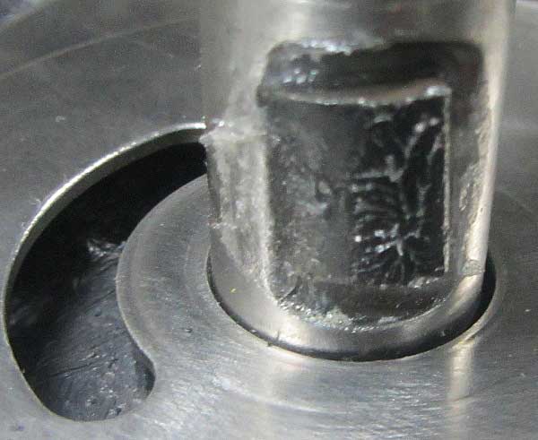

The impeller cam gets placed into the flat on the driveshaft and held in place with some OMC Roller Bearing grease. The sharp edge of the cam points in the direction of driveshaft rotation [clockwise].
Fig. 53. Impeller cam held in driveshaft flat with grease and pointing clockwise.
Try to position the impeller in the housing so that when you drop the pump housing down the driveshaft the impeller groove and the cam are aligned as closely as possible. In this way they will slide right into place with no drama. Make absolutely sure the driveshaft cam has engaged the impeller. If you look through the water tube hole you can just see the impeller pass by as you turn the driveshaft.

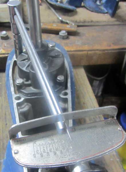

Once you are sure the impeller will turn with the driveshaft you can insert the stainless housing bolts into the holes that have been coated with anti-seize. Tighten the bolds with torque wrench and to the specified torque. [Moderator's note: here is a good place to insert the actual torque value.] If you strip these bolt holes the pump will leak.
Fig. 54. Torque wrench used to tighten housing bolts.
The water tube seal goes onto the housing dry with no sealer.
Fig. 55. Completed water pump.

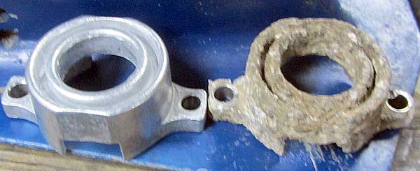

Next the propshaft sacrificial zinc anode goes on. If your anode looks like the one on the right side- replace with a new one like on the left side.
Fig. 56. New anode (left) and worn out anode.
The anode slips down the propshaft and two small stainless bolts secure the anode to the propshaft bearing carrier. Torque to specs.

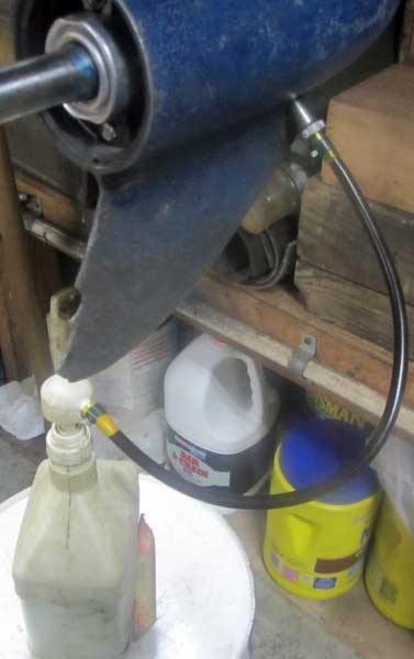

Next I replaced the water inlet screens on the sides of the gearcase. I also adjusted the shifter shaft depth as described at the beginning of the thread. You screw the shaft in until it bottoms. Then you unscrew it the number of turns you recorded at the beginning. The bent end of the shaft ends up pointing forward.
I filled the gearcase with clean used OMC Hi-Vis gearcase lube.
Fig. 58. OMC pump filling gearcase with clean used lube.
When I test the motor in a barrel of water I want the used oil to grab any dirt or debris that may remain inside from the rebuilding. After the motor gets to operating temps and there are no leaks or expensive noises I will drain it and re-fill with new oil. The final repair will be those chips missing from the skeg.

    Gearcase retaining screws 3/8": 18 to 20 foot-lbs
    Gearcase retaining screws 7/16": 28 to 30 foot-lbs
    Propeller shaft bearing housing screws: 120 to 144
    Upper Driveshaft bearing housing screws: 14 to 16 foot-lbs
    Shift rod cover screws: 60 to 84
    Pinion nut: 40 to 45 foot-lbs
    Pinion bearing retainer screw: 48 to 80
    Anode to propeller housing screws: 108 to 132
    Trim tab screw: 216 to 240
    Shift rod bushing: 48 to 60
    Shift rod pivot screw: 48 to 80
Shift Rod Height

Thanks Jim. While this repair concentrated on the 1993 to 2005 Evinrude 40, 48, and 50-HP engines, the procedures are common to earlier and different displacement motors as well.
I was afraid to take this job on because of the special tools and measurements required. I have the factory service manual and I found it indispensable. Not only does it explain all the step-by-step procedures but it identifies the tools required. It is available in printed form from various vendors as well as in PDF form on websites that post owner and repair manuals.
I found most of the tools needed for sale online, and I was able to adapt other common tools for various tasks. I wanted to show that a lower unit that was not damaged or hopelessly corroded could be rebuilt by the average DIY mechanic.
Most of the repair parts are easily available. While none of the parts or tools are inexpensive, the current cost of a commercially rebuilt lower unit far exceeds this investment.
As for the badly corroded unit I will continue with the overhaul and post my results.
