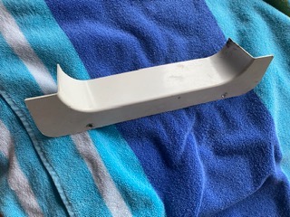

Postby grizzly » Thu Mar 24, 2022 7:13 pm
Fig. 1. One-half of the rigging tunnel escutcheon from a 1986 OUTRAGE 18.
I don’t know what happened to the other half. I am willing to use this as a template to 3D-print a new one.

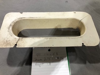

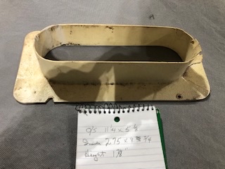

grizzly wrote:Hi Don. Can you post a picture of your old escutcheon? I am curious if it looks like mine, also from an OUTRAGE 18 boat.
The escutcheon from my boat may be warped and distorted.
[Measured dimensions of escutcheon from an OUTRAGE 18 boat]
OUTSIDE LENGTH = 11=1/4 x 5-1/8-inches
INSIDE PIECE = 8-3/4 x 2-3/4-inches'
HEIGHT from flat base = 1-7/8-inches
See Figure 1 and Figure 2 below.
Fig. 1. Flat surface side of escutcheon
Fig.2. Extension side of escutcheon
Nova Scotia

Re: 1986 Outrage 18 Rigging Tunnel Escutcheon
Postby Don SSDD » Sat Mar 26, 2022 12:25 pm
The floor the console [on my OUTRAGE 18 boat] is a sheet of 1/2-inch marine plywood with a sheet of vinyl glued on top. The escutcheon was placed on top of the plywood with the inner sleeve pointing up, where the wiring and cables pass through.
Q1: Was that marine plywood and vinyl factory installed?
I suspect not.
Q2: Shouldn't he escutcheon sleeve go down into the hole in the plywood so the sleeve acts as a guard to prevent debris from entering the tunnel and also prevents chafing on the wires and cables passing through the hole?
Postby jimh » Sat Mar 26, 2022 1:13 pm
As I recall, the escutcheon on both my 1987 REVENGE 20 and 1990 REVENGE 22 W-T Whaler Drive boats was the same as seen in Figure 2 above. The mounting was with the flat surface on the deck and the extension pointing upwards, again as seen in Figure 2 above.
Don SSDD wrote:Shouldn't he escutcheon sleeve go down into the hole in the plywood...?
My inference about the mounting orientation: I believe the purpose of the escutcheon was to help prevent any water on the deck from flowing into the rigging tunnel by that access point. Mounting with the sleeve going upward accomplishes that goal.
Don SSDD wrote:...so the sleeve acts as a guard to prevent debris from entering the tunnel....
I think the upward mounting works better for that purpose, too.
Don SSDD wrote:...and also prevents chafing on the wires and cables passing through the hole?
The sides of the sleeve in the escutcheon tends to center the cables in the hole cut, keeping them away from the cut edges, as the hole cut is probably larger than the inside diameter of the escutcheon opening.
I don't recall examining the laminate hole cut on my boats to see if the sides are rough. I would hope that Boston Whaler put a layer or two of laminating resin on them to seal them, and the surface is smooth.
The way my boat is rigged, the only cables running through the escutcheon into the rigging tunnel are: the hoses for the hydraulic steering, which do not move; and the SONAR transducer cable, which does not move.
Because my boat is a REVENGE with the helm on starboard, all the other electrical cables (for lighting, pumps, network cables, and the engine wiring harness are run under the starboard gunwale.
On center console boats, there would be more cables running through the rigging tunnel, but I would not expect any of them to move around.
Postby jimh » Sat Mar 26, 2022 1:31 pm
Another reason for the mounting of the escutcheon with the inner extension sleeve pointed upwards: this allows for a easier cable bend. If the extension pointed downward into the hole, then the cable bend radius would be reduced by the distance the escutcheon extended below the bottom of the deck.
A third reason: by pointing the extension upward, the accuracy of the rectangular cut into the deck was reduced. If the flange of the escutcheon had to precisely fit into the hole in the deck, the cut would have to be made rather accurately.
I don't recall any reports of damage to cables entering or exiting the rigging tunnel at the helm due to abrasion with the deck cut out. Skeptics of the orientation of the escutcheon as used by Boston Whaler should rely on their own judgement about which way it should be placed.
