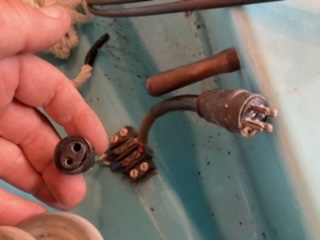

Fig. 1. A terminal strip [presumably near the engine splash well by deduction of seeing a Norman Pin in the background].
Q1: does the terminal strip both power the white all-round lamp and the bi-color combined sidelight lamp?
Q2: how is the pole lamp removed if wired to the terminal strip?
Q3: [what is the the reason] Boston Whaler did not route the navigation lamp circuits to the helm console?
On the helm console is one pull switch but nothing was wired to it.
The exposed wires running through the hull look good.

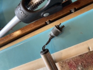

Fig. 2. [No caption provided. Please write a caption that explains what this photo is supposed to show the readers.]

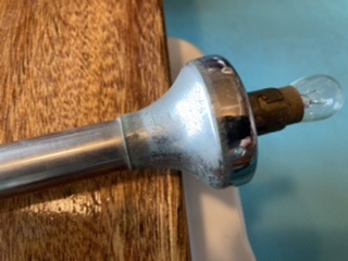

Fig. 3. The miniature electric lightbulb from the pole lamp.

In Figure 1 there is not enough detail to see if there is a circuit from the bow that is connected to the terminals.
Give a better view of the terminal strip.
Based what can be seen in Figure 1, it appears that two external cables are terminated on the two-pole terminal strip. Also, the position of that terminal strip appears odd. Usually the terminal strip is located on the inwale or cockpit bulwark, and the hidden wiring from the combined sidelights lamp connects to the terminal strip.
Continuing to refer to Figure 1, one cable has a connector with two sockets. The other cable has a connector with four pole connector with four pins.
Referring to Figure 2, something else in the boat--perhaps a pole lamp for the white all-round light--has a two-pole connector with pins. My inference is that cable is intended to mate with the two-pole connector with sockets at the terminal strip.
If there is nothing wired to the pull-switch at the console, then that switch cannot control the navigation lighting.
Is there another connector on the boat that has four-poles and has sockets?

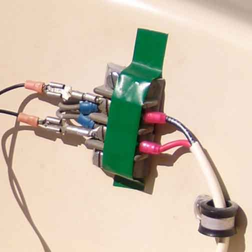

Figure 4 below shows the terminal strip location on my 1976 SPORT 15 boat.
Fig. 4. The OEM terminal strip on a 1976 SPORT 15. The pole lamp circuit connected by push-on terminals to allow the lamp to be removed and stowed. The combined sidelights lamp connects by wiring running in the hull, seen as the conductors with GRAY insulation, The red/black two-conductor cable brings power to the circuit from a switch on the helm console. The terminal strip is on the aft port inwale or cockpit bulkhead.
The push-on connectors were a bit of a kluge fashioned by a previous owner. They were not elegant, but they worked. The boat was always used in freshwater, so there was not much concern about weather protection.
In many Boston Whaler OEM installations a small plastic molded lightweight cover was installed to protect the terminal strip from weather and splash.

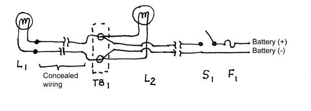

The typical circuit for navigation lighting on a small Boston Whaler open skiff would be as shown below in Figure 5.
Fig. 5. Typical navigation lamp circuts.
LEGEND
F1: fuse; 3-Amperes
L1: incandescent light bulb in combined sidelight lamp fixture at bow
L2: incandescent light bulb in white all-round pole lamp fixture at transom
S1: single pole single-throw pull switch at helm console
TB1: two-pole terminal binding strip, usually near transom
In some instances on small boats, switch S1 and fuse F1 were omitted. The lamp circuit would be connected directly to a small lantern battery. This was quite workable for small boats used mostly during daylight, and on boats with no engine cranking battery that used pull-start engines.
The wiring from L1 at bow was run inside the Unibond hull to the stern. The wiring exited near the transom on the inwale or cockpit bulkhead, often on the Starboard side, but occasionally seen on the Port side.
