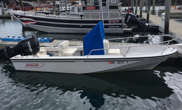

Q1: what is the stock fuel tank capacity for a 1994 OUTRAGE 17?
My boat guy thinks the stock fuel tank capacity is 35-gallons.
To me [the fuel tank capacity of a 1994 OUTRAGE 17] seems like it may be more [than 35-gallons] based on [the volume of fuel] I added to the fuel tank, and on the reading of tank level on a new gauge.

The fuel tank capacity is 32 gallons. Under the middle inspection cover you should be able to see a aluminum colored rectangular sticker with the specificationss.

Nick Burnett wrote:Q1: what is the stock fuel tank capacity for a 1994 OUTRAGE 17?
See the specifications in the REFERENCE section at
https://www.continuouswave.com/whaler/r ... hulls11-19
