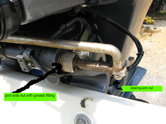

    The steering cable has two parts, an outer sleeve and an inner cable and rod. The sleeve bolts on to the starboard side of the engine and the rod slides through the tilt tube of the motor. The rod is connected to the motor by the steering drag link arm. The tilt tube needs lubrication. Lack of lubrication and water can cause corrosion. This results in the rod sticking.
    Warning: if your steering is stuck, do NOT try forcing the wheel to turn. There are small teeth in the helm (behind the wheel) that can break. If several teeth break, you will need to replace your helm.
    Verify the steering cable is stuck by removing the steering drag link arm from the rod. With your hands, grasp the motor and move it. If it moves, the steering cable is the source of the problem.
    The easiest method that can free a slightly frozen rod is using the engine tilt motor to try to break the rod free. When the motor moves the rod does rotates slightly. Repeated tilting full up and down can break free a rod.
    steer copy.jpg (98.12 KiB) Viewed 8384 times
    If still stuck, with the steering drag link arm still disconnected, remove the port side nut from the engine bracket. Spray heavy amounts of penetrant like PB Blaster into the tilt tube. Keep some rags or towels handy. Let this soak for a few hours. Repeated spraying and letting it sit helps reduce the effort to break it free.
    Wrap the flat end of the steering rod with a towel and use a wrench or adjustable and gently rotate up and down while having a helper put light pressure on the wheel.
    If not successful, unbolt the starboard side nut that attaches the cable to the engine. With a block of wood and a hammer, drive the port side end of cable. A combination of force and spraying penetrant will break it free in most cases.
    If the cable will still not budge, the last resort is to use heat. With a propane torch (not MAP or other high temperature fuels) apply heat to the tube. After a few minutes, whack the cable. Repeat the soaking and apply more heat and hitting the cable.
    Unfrozen and Prevention
    Now that your cable is unstuck, you should take the time to make sure it doesn't happen again. If the boat is new to you or has not been serviced recently, removing the steering rod, cleaning the tube and reinstalling with fresh marine grease is recommended.
    If your rod does not have a nut with a grease fitting on the port side,it is highly recommended you install one like the one shown in the photo above. One brand is Steersman_Nut

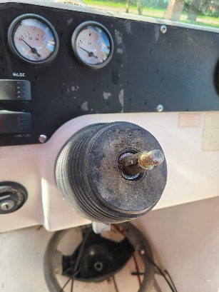

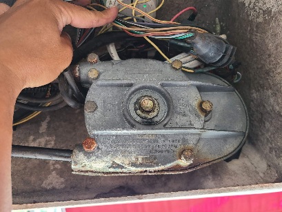

Thanks again. I don't know where to begin on how to remove the helm. Please see attached pictures.
Fig. 1. No caption
Fig. 2. No caption

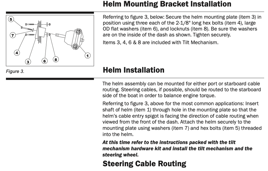

Q3: Can the bellow and cover and tilt mechanism still be reused in conjunction with the new helm?
See this link:
https://www.wholesalemarine.com/telefle ... lAQAvD_BwE
Jude
1997 BW Dauntless 17 115hp Merc
Re: 1997 Dauntless 17 DC steering cable stuck
Postby Phil T » Sat Jul 02, 2022 8:52 pm
If you want the tilted helm kit then your link is appropriate replacement.
If the cable is frozen at the engine, to remove it from the helm will require you to unfasten the helm from the dashboard first.
Remove the black round bellows.
Unfasten the bolts that hold the helm in position.
See this drawing as a guide:
Dwg. 1. Helm Install/Removal
Screen Shot 2022-07-02 at 8.48.18 PM.png (140.04 KiB) Viewed 8356 times

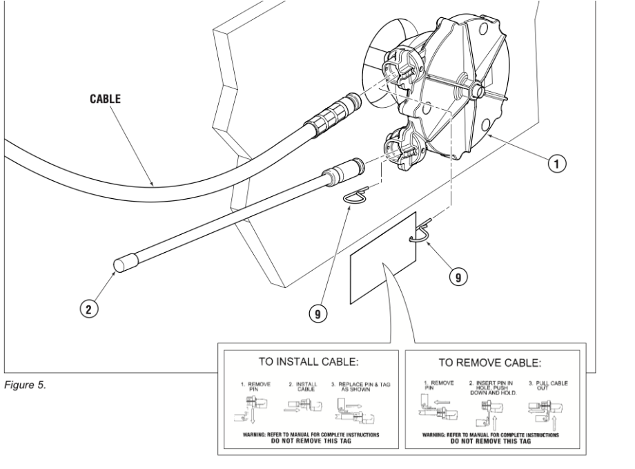

To remove the cable see this as a guide. Pull the pins and turn the steering shaft while allowing the helm to move.
Dwg. 2. Steering Cable Removal From Helm
Screen Shot 2022-07-02 at 8.48.59 PM.png (156.46 KiB) Viewed 8356 times
