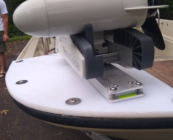

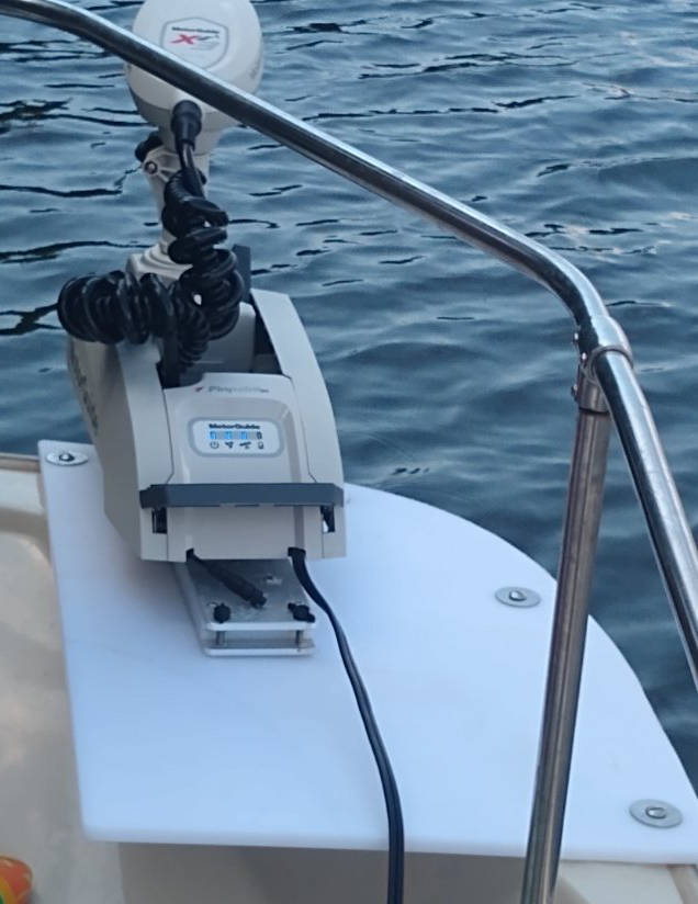

I show how I mounted a trolling motor to the bow on my 1987 MONTAUK in Figures 1, 2, and 3.
I could not through-bolt the trolling motor mount to the deck. Instead, I made a plate out of High Density PolyEthylene (HDPE) that is 1/2-inch thick and cut in a shape that matches the Starboard corner of my 1987 Montauk.
Fig. 1. The 90-degree corner of the white, high-density polyethylene mounting plate needs to be trimmed.

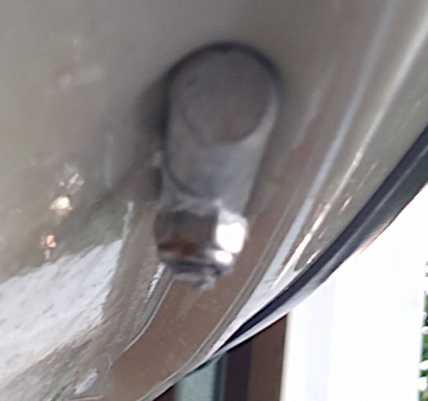

The HPDE plate is through-bolted using the lip under the rub rail to hold 2-inch-long sections of 7/16-inch OD round aluminum rod drilled to accept a 1/4-inch bolt. The rod spreads the load over a larger area, and that part of the boat is quite strong. I used four bolts spaced evenly.
Fig. 2. Unusual round spacers or washers were made from 7/16-inch aluminum stock and fit in the groove of the molded hull.
The trolling motor is attached to the custom made HDPE plate using four machine screws and four stainless steel T-nuts. I also used two stainless steel wood screws. I drilled a pilot hole for the two middle screws that were in the area of the embedded plywood backing that Boston Whaler inserts into the bow gunwale corners.
Fig. 3.
The 9-inch shuttle slide I am using allows the whole trolling motor to retract inside of the rub rail. You can see the different positions in Figures 1 and 3.
I highly recommend the shuttle slide trolling motor mount. It allows you to retract the trolling motor so that it retracts behind the rub rail to avoid damage when docking, but allows you to slide the trolling motor forward to deploy.
