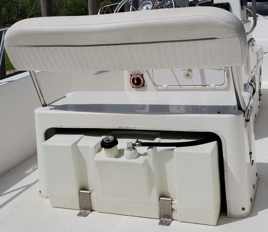

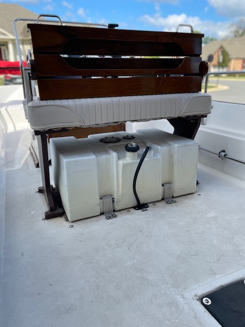

Figure 2 below shows someone’s rigging of a fuel tank on a 170 MONTAUK.
I don't know how the hose was routed. On my 2014 170 MONTAUK boat, if I slide the 23-gallon on-deck fuel tank into place [under the pilot seat], then the fuel will be sitting atop the fuel hose as the hose enters the [opening on the deck].
Fig. 2. A photo of some other boat shows the installation of a 22-gallon fuel tank under the pilot seat of what is believed to be a 170 MONTAUK.
22 gallon tank on Montauk 170.jpg (34.23 KiB) Viewed 9988 times
Re: 2014 170 MONTAUK: Fuel Hose Route with 22-gallon Tank
Postby jimh » Sun Oct 30, 2022 9:39 am
The on-deck Moeller white fuel tank shown above in Figure 2 has been moved aft about three inches. I presume the fuel hose enters the rigging tunnel on the forward side of the fuel tank.

jimh wrote:The on-deck Moeller white fuel tank shown above in Figure 2 has been moved aft about three inches. I presume the fuel hose enters the rigging tunnel on the forward side of the fuel tank.
Jim is correct.
Figure 2 illustrates my 2005 170 Montauk with the 22-gallon Moeller on-deck fuel tank. The fuel hose does indeed enter the rigging tunnel on the forward starboard side of the deck under the RPS.
I removed the RPS and used the permanent aluminum Moeller hold down kit. I then routed the fuel line and the reinstalled the RPS.
Jim is again correct in noting that by also moving the tank slightly to the rear fueling the tank becomes much easier as the filler neck is readily available. I do not recommend mounting this tank almost flush to the front of the RPS.

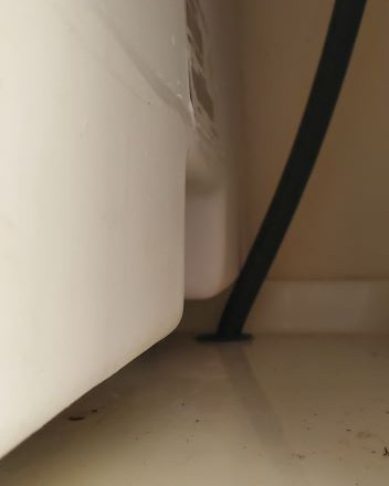

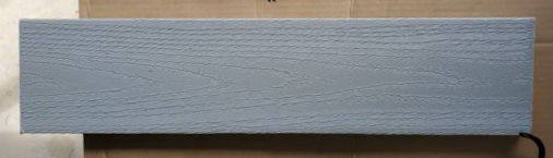

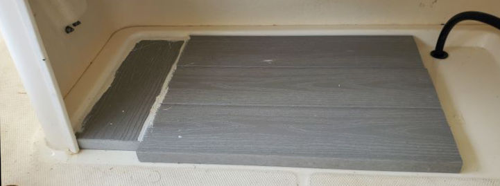

I returned to my Boston Whaler 2014 170 MONTAUK boat, and I have now installed the 22-gallon tank using the plastic deck boards to lift my tank 1-inch higher. I used a small amount of 3M4200 to secure the boards.
Fig. 3. One of four plastic deck board with dimensions 24 x 5.5 x 1 inches used to raise the fuel tank above the deck.
Fig. 4. Deck boards in place under RPS and adhered with 3M4200 adhesive sealant.
Lifting the tank allows the original hose location to be used and helps to move the tank forward under the RPS.
Fig. 5. The raised fuel tank allows the fuel hose to use the original location of the fuel hose entry point into the deck.
This results in a few inches more deck space at the aft end yet still having good access to the fill cap.

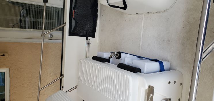

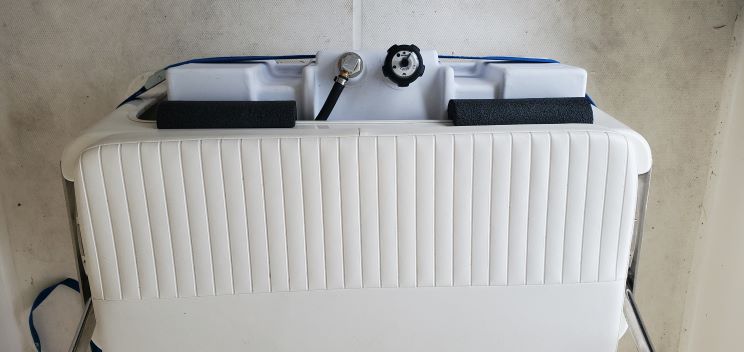

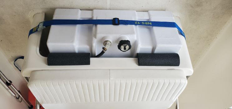

Fig. 6. Top view of the fuel tank under the RPS.
tank top view.jpg (34.5 KiB) Viewed 9590 times
Fig. 7. View of fuel tank from aft side of RPS
tank front view.jpg (33.09 KiB) Viewed 9590 times

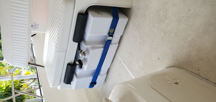

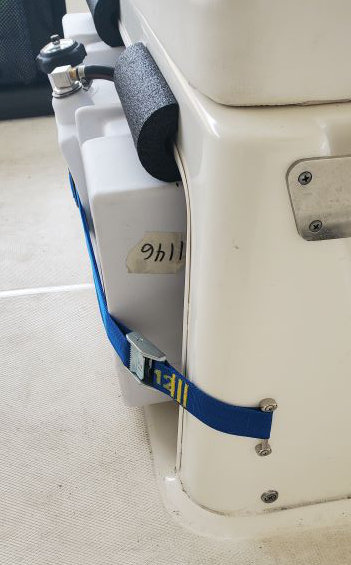

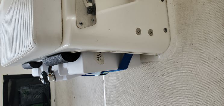

Fig. 8. Close up showing foam spacers, location of footman's loops, and the retaining strap.
The only holes I drilled were to attach the stainless footman's loops to the RPS. These loops anchor a 1.5-inch-wide strapsused to secure the tank. A 9- to 10-foot-long strap is adequate.
The tank fits tightly, and it is hard to budge once the strap is pulled tight. I added some insurance by placing non-skid plastic shelving material between the tank and deck boards. I also used some 3-inch-diameter plastic packaging material between the RPS top and tank. It seems to be locked in quite tightly now, but I’ll monitor to see if it remains tight after a few fishing trips. I’ll report any important findings to the forum.
In summary. the advantages to this method are:
  • no holes drilled into the deck
  • RPS does not need to be removed
  • easy removal of tank if necessary for cleaning or inspection
  • easy install
The disadvantage are
  • plastic deck boards or other KING StarBoard-type material are expensive unless you have a neighbor with scraps (like I did)
  • not field tested yet

Your method of raising the tank in order to preserve the original fuel hose routing to the through-deck access hole is quite crafty.
You might consider inverting the mounting of the Footman's Loop retainers to be on the inside of the RPS base, still using the same location and same holes. This would give the strap more pull on the tank and also look a bit cleaner. All that would be visible on the outside would be the screw fastener heads.
jh imp 3.jpg (40.8 KiB) Viewed 9507 times
jimh improvement.jpg (40.08 KiB) Viewed 9507 times
improve 2.jpg (49.15 KiB) Viewed 9507 times
Postby jimh » Sat Dec 31, 2022 6:40 pm
Your revised location for the holding strap looks very good.

I've now had a few months of use with my new tank and it is staying well secured. Although I'm wondering how this Moeller tank is vented.
The cap doesn't have an obvious vent but it may be happening through the little black fitting on top of the gauge?
Also do I need to place a fuel demand valve into my fuel hose system? I have a 2014 90 HP 4 stroke EFI Merc. I'm assuming those fuel demand valves are more useful for older carbureted engines (to reduce spills/emissions), but I see they came with my original 6 gallon tanks with the same motor. Is there a legal requirement to have a demand valve integrated into my fuel system?
I look forward to a reply.
Postby Phil T » Fri Mar 31, 2023 3:21 pm
The vent is in the cap.
No to installing a fuel demand valve. Not required. They cause nothing but trouble. You don't need this.
Sorry to be the naysayer but I don't like the tank not fully supported. This design could lead to a structural failure down the road.
