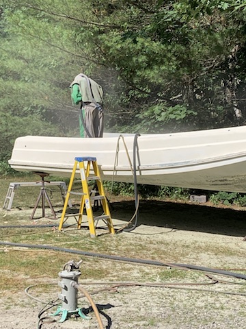

After the 1974 OUTRAGE 21 boat was stripped of all gear and put on stands, I [glass bead] blasted and ground off all the gel coat layer. When the gel coat has cracks and even crazing this is a result of stresses induced when pounding in waves.

Fig. 2. Blasting the gel coat with glass beads.

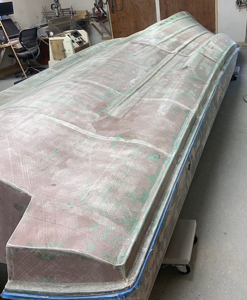

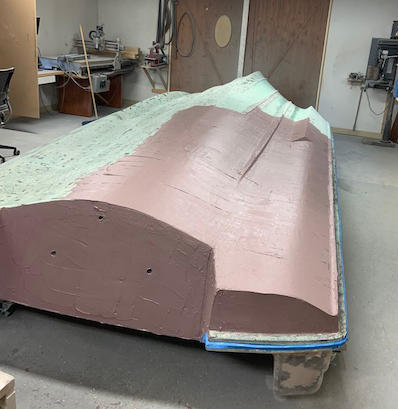

Fig. 3. After the gel coat layer was removed by abrasion, a fairing compound was applied to the hull.

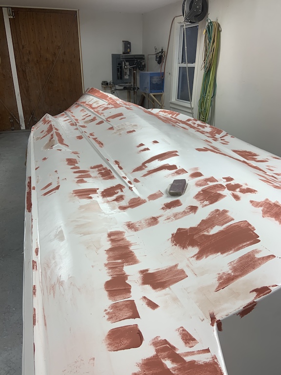

Figure 4 shows more fairing with ALEXSEAL brand two-part fairing compound.
Fig. 4. More fairing and sanding of the hull. Compare to Figure 3, above.

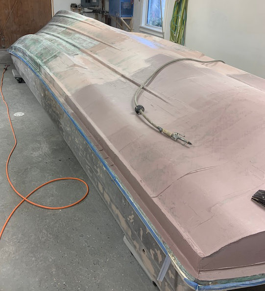

After sanding and fairing, 12-ounce bi-axial cloth [wetted] with Hawk epoxy was applied over the entire hull.
Fig. 5. Applying new cloth to the hull.

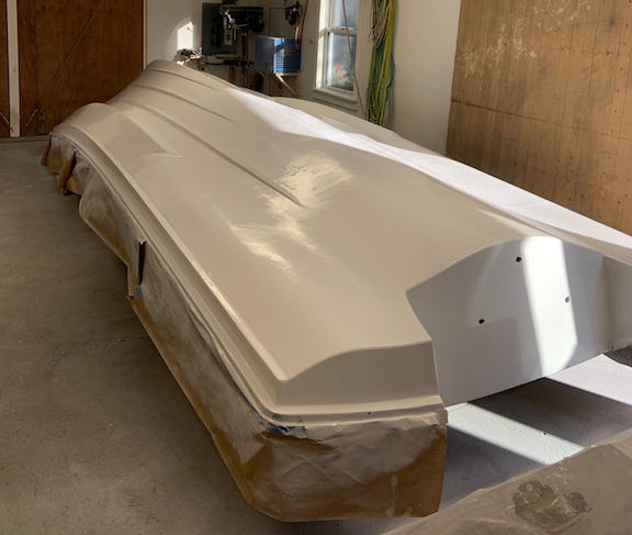

After application of ALEXSEAL brand two-part high-build-primer the surface smoothness is good but not perfect.
Fig. 6. The hull bottom after the first coast of high-build-primer. The finish is already looking good.
I will chase small blemishes and spray another coat of ALEXSEAL brand high-build two-part primer. That will be followed by finish primer and then a topcoat.

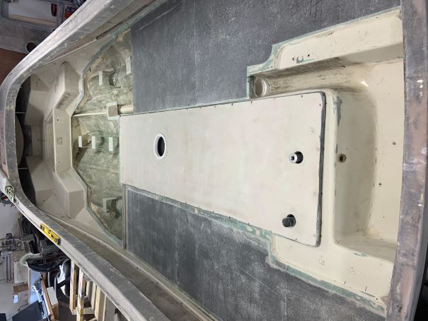

The rebuilt fuel tank hatch cover. The plywood core was rotten so a new core was created using vacuum-bagging techniques.
tank cover.JPG (49.34 KiB) Viewed 7770 times
Q6: what is the proper sealant is to create a watertight enclosure?
Re: 1974 Outrage 21 Restoration
Postby jimh » Tue Apr 04, 2023 11:09 am
Sunnybreeze wrote:Q6: what is the proper sealant is to create a watertight enclosure?
If you want to fill the gap between the permanent deck and the removable fuel tank cavity cover, use a marine caulk. Do not use a strong adhesive-sealant such as 3M5200, 3M4200, 3M4200 FF, or similar very strong adhesive products. You just want a marine grade caulk. You could even use a tinted silicone bathtub caulk; some are available in off-white hues that will be a nicer match to the gel coat color. If your new deck color is just pure white, then use white caulk.

Looks great so far. Good work. Consider the following, based on what I've encountered with my 21'.
1 - It's pretty difficult, I'd even say impossible to totally eliminate water penetration into the fuel tank cavity. What I ended up doing was drilling a drain hole in the rear, to empty into the aft bilge area. 5200'ed a 1" pvc pipe, and didn't caulk down the cavity cover. At the end of each season, I remove the cover and power wash out trapped debris.
2 - I found that water will pool in the flat area between the gunwale "ridges", roughly underneath the stainless steel grab rails. Either when on the trailer or at rest in the water. We ended up doing some pop up cleat repositioning, and during the time it was in the shop, we cut a notch in the outside gunwale ridge. Now, water will not pool. Had considered drilling a 3/8" hole in the low area, epoxy in a 2" piece of flared brass and run some plastic tube to another hole just above the rub rail. Decided that would have a tendency to clog, so went with the notch. If you want, I can send an image of that area.
