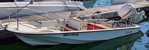

I recently bought a 1982 Striper 15.
Fig. 1. a STRIPER 15 boat.

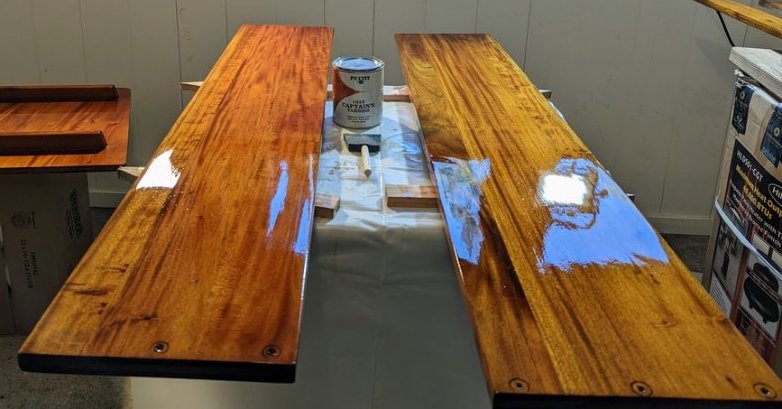

In preparation for boating season here in the Seattle area I'm sanding the boat’s vintage thwart seats down to bare wood and refinishing with Petit 1015 Captain's Varnish.
Fig. 2. Re-finished thwart seats on workbench.
Recently I've decided to install two Tempress Navistyle seats on the aft [thwart seat] to make the ride more comfortable for my creaky knees. I'm debating whether or not to drill four holes in each of the vintage mahogany thwart to install the two Tempress Navistyle seats.
[To see the seats that are mentioned to be installed visited https://www.basspro.com/shop/en/tempress-high-back-navistyle-boat-seat .]
Give me your opinion on drilling four holes in the vintage mahogany thwart seats to mount two Tempress Navistyle seats
Assuming I like the seats [the new Tempress Navistyle seats], the thwart seat will just sit in the garage forever, but drilling them is a one-way door decision.
If I don't drill, [a local lumber supplier called] Crosscut Hardwoods here in Seattle has 18mm mahogany plywood—11 ply Murante face cross laminated. But at just under 3/4-inch thickness I'm concerned [that thwart seats made with this wood] will flex.
READERS: give me your experience with similar 18mm mahogany plywood
