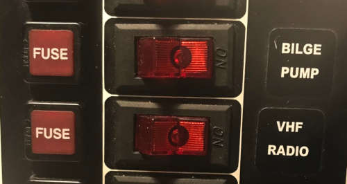

I do know the Bilge Pump switch on the console is a lighted, on/off rocker. No "auto" position, and it is not a momentary switch.
Fig. 1. Two switches on the electrical panel of a 1991 OUTRAGE 17 boat.

If the other circuits have illumination when their switch is moved to the ON position, and neither of the two switches shown in Figure 1 behave in that manner, the first component to check is the FUSE.
The fuse is probably accessible by prying out the square red lens marked FUSE. That is probably part of the fuse holder. Check to see if the fuse is good. If the fuse has a glass envelope, you can visually check the fuse by carefully looking at the fuse element inside the glass tube. If the fuse does not have a glass tube envelope, you can check the fuse with an Ohmmeter.
If you have a bit of fingernail on your thumb and an opposing finger, you can probably pry out the red square lens marked FUSE. Or, there may be a latching mechanism; if there is a latching mechanism you may have to push down the red square lens marked FUSE, and that will release the latch mechanism.
Report your results with locating the fuse and testing the fuse for continuity. More advice an be given after you assess the state of the fuse.
ASIDE: A fundamental rule in electrical circuit diagnosis: if a circuit is protected by a fuse, and the circuit appears to not be energized, the first component to check is the fuse that protects that circuit.

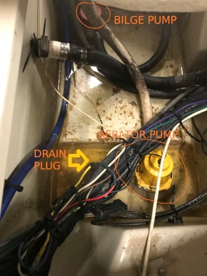

I lifted up the live well (I did not know you could do that, it was like finding a secret hiding spot) and sure enough, I see the electrically-operated pump and also an aerator pump for the live well. I also noticed the aerator pump is lower and there is a drain plug there that opens straight down. There was also a six inch plastic tube there with holes in it.
Fig. 2. Annotated photo showing stern sump area of OUTRAGE 17.

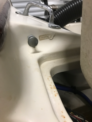

Next I noticed two plug switches on either side of the live well. One on the starboard side has a faded label "aerator". The one on the port side has no label.
Fig. 3. A push-pull electrical switch controlling power to the aerator pump.
I put six gallons of water in the sump. Then I applied power to the circuity marked "Bilge Pump" on the console. When I pull the port side switch, the bilge pumped hummed for a moment then started pumping out water from the sump. When I pulled the switch on the starboard side [labeled "AERATOR"], the aerator pump hummed but did not pump any water into the live well. I am guessing my aerator pump is bad or plugged.
My conclusion is that in order to run the bilge pump I have to supply voltage to the stern with the console switch, then pull the second switch in stern, port side. Likewise I pull the aerator switch to aerate the live well.

Yes it is apparent to me (the third owner) that the boat has gone through some non-OEM changes. I would be interested to see the original setup. In the meantime, I'll keep discovering how the current setup works.
I pulled that aerator pump which is in the lowest part of the sump. When I pulled the top half of the aerator pump I could see the bottom half had a hole through the hull to the bottom on the boat. So the current setup must draw water up when the boat is in the water (as you folks mentioned). And yes, both the live well and bilge pump vent water to the splash well.

Regarding the use of a pull-switch to control a pump, as seen above in Figure 3: initially I did not think this could be a factory installation, but recently I was aboard another Boston Whaler boat, a WHALER 25 Walkaround with Whaler Drive boat, whose electrical system and pumps are much more complex than on a 17-footer. I noticed that in rigging that boat the factory used two pull switches to control two pumps. On that basis my opinion has changed: the pull switch to control the pump on your boat could very well be originally rigged by Boston Whaler. The pull switches also had similar labels as shown in Figure 3.
