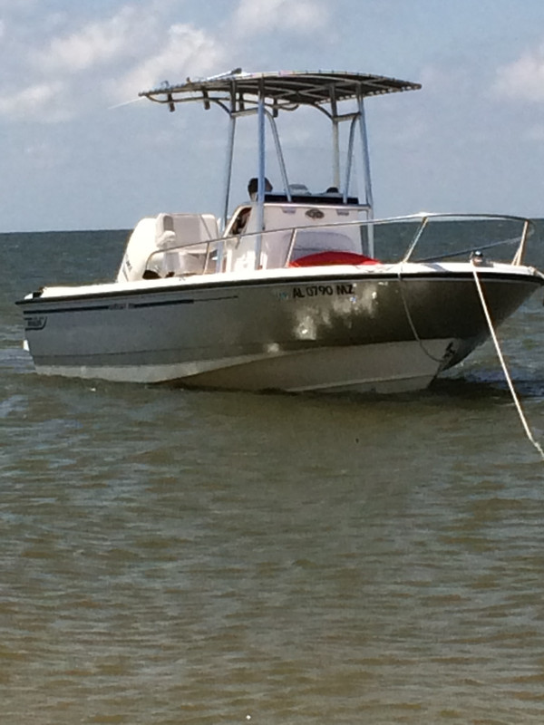

I bought a 2003 190 Nantucket in 2017. Same hull as yours. It came with a T-Top. No problems except brushing some low hanging branches in my neighborhood.
https://i.postimg.cc/Ssf43NVz/98-FC4423 ... BC7220.jpg
