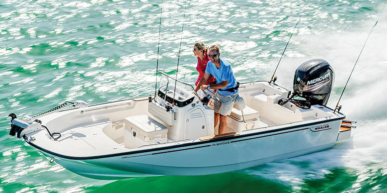

I have a [unspecified model year 170 MONTAUK] boat, and I want to mount some stern cleats.
[Says he would like to see photographs with dimensions indicating where to mount the cleats.]

In the prior discussion there is a PDF file showing the location of the embedded reinforcements in the hull that are intended for mounting stern cleats. The OP in that thread gives more information in his narrative about the location.
Your local Boston Whaler dealer may have more information to offer, or perhaps has a similar boat with stern cleats from which you could take a measurement.
You could also contact Boston Whaler customer service to see if they can offer additional information on the exact location of the embedded material.
You can also use available photographs to infer the location. For example, see the image in Figure 1, below:
Fig. 1. A 170 MONTAUK photograph that shows the location of stern cleats.

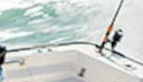

Use the photograph to infer the location of the embedded material. In the photograph there are other portions of the boat near the stern cleats whose dimension you can measure from your boat. For example the distance from the transom to the turn in the gunwale downward can be measured from your boat. Next, enlarge that area of the image, as shown in Figure 2, below.
Fig. 2. A portion of Figure 1 enlarged to permit better measurement of the area of interest.
View the enlarged image on a large monitor. Orient a scale so it follows the orientation of the view in the photograph, which may not be perfectly horizontal. On the scale measure the distance from the transom to the turn in the gunwale; note this as variable A. Then use the scale to measure the distance of the cleat base from the transom; note this as variable B.

Let's say from the photograph above the value of X is 2. Let's say on your boat the value AA is 5-inches. Then the distance of the cleat base (BB) would be 10-inches.
Find another photographs and repeat the process. If the value of BB remains the same, you have found the dimension you are looking for.
