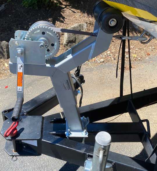

The depth of my garage is only 19-feet 9-inches [or two inches shorter the the garage under discussion]. My 1987 [MONTAUK 17] is positioned between the fenders of my trailer, There is a clearance of about three-inches on each side between the garage door frame and the trailer fenders.
I was able to modify remove the OEM trailer winch post and substitute a winch post that was more compact.
I have added a swing tongue to the trailer.
When the garage door is closed, only two inches of clearance remain [between door and trailer], and the bow of the boat is eight inches from the door.

The standard winch post provided on my LOAD-RITE FIVE STAR galvanized boat trailer was abnormally long; if left in place the trailer length would have been about six or seven inches too long to fit my garage.
LINK TO AMAZON website listing for "Short Nose Adjustable Winch Stand W/ 1400lb Dutton- Lainson Winch (Galvanized)"
https://www.amazon.com/Die-matic-Adjust ... 01LDS2UKK/
LINK TO AMAZON website listing for "Sturdy Built Boat Trailer Galvanized Winch Seat for 2 or 3 inch Width Winch Post"
https://www.amazon.com/Sturdy-Built-Tra ... 0B6L48JF3/
I removed the LOAD-RITE winch stand bow roller bracket and substituted the sturdy built winch bracket as shown in the second link above. I also cut down the height of the winch post above the winch bracket.

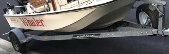

I am going to measure a PACIFIC trailer that is included in particular MONTAUK 17 boat I may buy, seen in Figure 1 below [for what is assumed to be an estimation if the boat and trailer will fit into a particular amount of space available in a particular garage].
Fig. 1. A PACIFIC trailer that may be measured.

I also might be able to get the winch post behind where the trailer [frame main tubes widen and] split, similar the winch post seen Figure 2 below.
Fig. 2. Trailer winch post configuration to save space. Photo credit MarkCz.

Regarding a PACIFIC trailer: I owned a PACIFIC trailer. I bought it as a used trailer under a boat I was buying. The quality of construction of the PACIFIC trailer was excellent. Their design for a winch post is a bit unusual.
