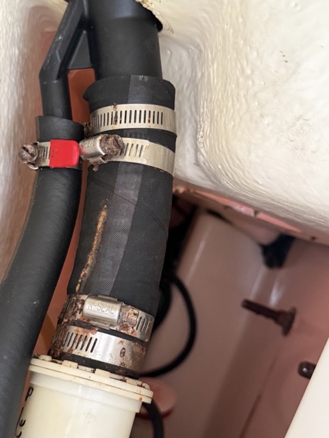

Fig. 1. Rubber hoses perhaps part of fuel system.

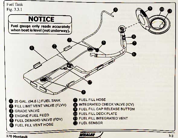

Fig. 2. A photograph of a drawing of fuel system.

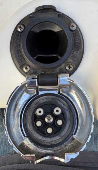

Fig. 3. Fuel cap open position.

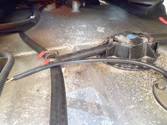

Fig. 4. Fuel tank top.

Replace the thru-cap-vent-fill fitting.
Some owners have replaced the combined vent-fill fitting with separate fill and vent fittings.
PERKO makes decent fittings.

Check the tightness of all the worm-gear hose clamps seen in Figure 1.
Q2: are those worm-gear hose clamps part of the OEM installation?
As the boat is still quite new, contact the dealer for advice and possible remedy at no cost under warranty.
Q3: why is there (what looks like) sand laying on the top of the fuel tank and and the fuel limit valve as seen in Figure 4?

jimh wrote:Check the tightness of all the worm-gear hose clamps seen in Figure 1.
I will go through all the hose clamps, and, in fact, I have found one that was broken already.

jimh wrote:Q2: are those worm-gear hose clamps part of the OEM installation?
As far as I know the hose clamps and everything is OEM.
jimh wrote:Q3: why is there (what looks like) sand laying on the top of the fuel tank and and the fuel limit valve as seen in Figure 4?
Good question about the sand. I don't know [its source]. The sand is somewhat stuck in place.
I had to re-caulk the deck seam surrounding the helm seat as there was a cut in the caulking all the way around, as if someone had used a knife; it was causing water to leak into the sump space below the deck. I asked previous owner if deck had ever been removed, and he said no.

I tend to agree with JimH on this subject. I suspect your vented gas cap only vents into the tank (and not out) as prescribed by the various and numerous idiots in Washington DC. The gas cap came from a vendor and that vendor has the specs. There you will most likely find that the vent is a one way. If not, then bugs have plugged your vent line and they can be blamed if you can find them. I would suggest a new fill cap that is somewhat older and more reliable or separate the vent line and add that to your boat. It's only the first hole you drill in your Boston Whaler that hurts the most...
