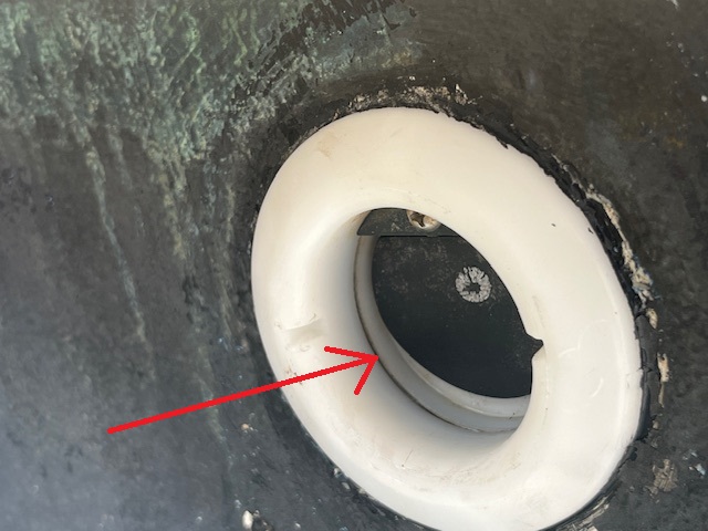

On my [2004 190 Nantucket boat's below-the-waterline through-hull fittings] I noticed there was a break in the fitting outlet below the water line under the swim platform (as was previous the topic of a long dormant thread from seven years ago].
I do not know know how long the through-hull fitting has been broken.
I first noticed the broken through-hull fitting when as part of a maintenance project I began taking off all-through hull fittings [on the 2004 190 NANTUCKET]. I began that project because two brass through-hull fittings in the engine [splash well] were weeping a brow watery liquid.

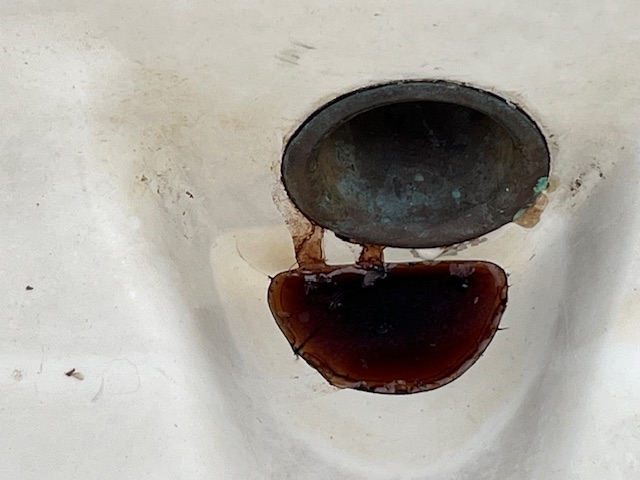

Fig. 1. Engine splash well brass drain with brown seepage.

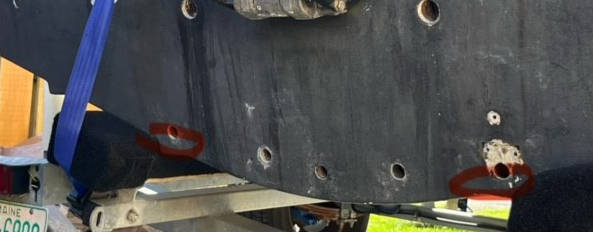

Fig. 2. Red arrow points to broken plastic through-hull fitting on transom below water line.

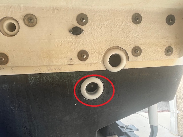

Fig. 3. Red oval indicates the location of the below-waterline plastic through-hull fitting that has failed.

In mid-Summer 2024, I started noticing brown water on a cockpit drain and engine splash well drain on Port. My driveway is slopped such that when I park the trailer, the port side sits lower.

Then I found a cracked through-hull fitting connected to 1.5-inch hose leading to livewell drain, with the crack occuring very near the outboard end of the fitting on the transom. I suspect as the hose shrunk through the seasons, it put pressure on the plastic thru-hull and it eventually cracked
I could pull the ring-portion of the cracked fitting with my nails and it literally broke off. There was sealant around the fitting but sealant was separated from the wood. I could pull the thru-hull easily from the inside.

Q7: what is the purpose of the many machine screw fasteners with large washers on the transom of your boat as seen in Figure 3?

jimh wrote:Q7: what is the purpose of the many machine screw fasteners with large washers on the transom of your boat as seen in Figure 3?
The screw fasteners seen in Figure 3 are for the swim platform. I am sure that is from the factory. The screw fasteners are not through-bolted. The swim platform is solid.

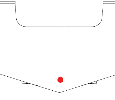

Fig. 4. The red dot shows the location of a test hole that was drilled. In case this illustrations is not clear, the hole was located on centerline at the transom a few inches above the hull bottom.
Q9: can water enter the foam that is between the outer skin [the hull] and the inside skin [the liner] below the engine splash well?

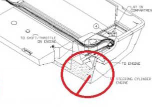

jimh wrote:The result is that when a hole is made through the transom, the hole will expose some of the foam layer, and if water can enter that hole, it will be in contact with the foam. The extend that the water will be absorbed into the foam cellular structure should be limited. But the water can certainly travel in the wood, producing problems. Note that saltwater does not tend to cause rot in wood. To create rot in wood requires freshwater.
This does not seem like a smart design from Boston Whaler.
If I am following correctly, [the construction of a Boston Whaler Unibond hull] means transom water intrusion will expose the foam to water. From what I know, the foam will somewhat saturate with water.
Fig. 5. A section from a drawing from Boston Whaler showing construction of a Unibond hull for the 190 NANTUCKET. A red circle and a red line direct attention to the area of the hull near the transom.
Q10: how can I know if water has saturated the foam?

Postby islavov » Sun Oct 06, 2024 7:41 pm
In an attempt to dry [the water in the hull at the stern] I made five 1-inch diameter holes at the lowest edge of the transom about 1.5-inches from the hull bottom [as seen in Figure 6, below in the next post].
I could clearly identify and feel an inner fiberglass skin on the inside of the wood. The embedded wood was wet, but it was bright and solid.
Over the winter I am an optimistic the wood will dry. Then, after I research exactly how, I will apply a treatment to the wood.
There may be different methods [to remedy the problem of the embedded wood in the transom being wet], and some will say when the transom is wet then it is done [that is, the embedded wood cannot be repaired], but I have to try [some yet-undetermined method to save the wood in the transom].
From [removal of] one screw fastener from the [SONAR] transducer [mounting bracket] the ingress of water [into the transom] was apparent.
I have been using a wet-dry vacuum suction, blowing fans, and wetting the holes with acetone to help remove water from the wood. The [five 1-inch diameter] holes [I made in the transom] are noticeably drier after just a couple of days of sunny weather.
I also drilled through the inner fiberglass skin in order see what was behind it on two of the five holes I made. I could feel and see fresh dry foam [that looked like] it was injected yesterday. This gave me relief knowing the hull foam is dry.
I kept the round fiberglass pieces from the hole saw tool, and I will use epoxy to adhere them back into place. I have to make sure to maintain the barrier between the foam and the wood in the transom.
The two of the low holes I made in the transom close to the hull bottom seemed to both have some foam below the wood: I found that interesting. The foam in one location was bright yellow, but the foam in the drying hole near where the transducer mounting bracket was fastened was somewhat darker and wetter (as seen in Figure 6 below). That indicated to me there was a problem with one of the transducer screw fasteners.
For now the winter is for the transom to dry, and it is going to be long winter.

Fig. 6. In the most Port and Starboard lowest holes (circled in a dark red that is hard to see) I can feel some foam. The foam in the Starboard side hole where the SONAR transducer was mounted is darker and wetter than the foam in the Post-most hole.
Re: Concern for Broken Through Hull Fittings
Postby jimh » Mon Oct 07, 2024 8:06 am
I would use alcohol to wet the water and make it tend to evaporate faster. Acetone is more expensive than alcohol, and it might be harmful for the wood and foam in repeated applications.
