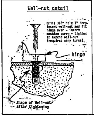

To save readers the time and trouble pf downloading the Boston Whaler document you refer to, I include an illustration that is an excerpt from the drawing:
The situation illustrated is similar in both instances: there is NO embedded wood reinforcement under the gel coat and laminate layer at the location of the hinge plates for the Bimini top frame.
Regarding which method to use, it is really your choice. I would, however, suggest if you use the metal expansion nut then also employ some sealant to avoid allowing seawater to get into that metal part and producing rust or oxidation. The Boston Whaler drawing does not give a recommendation for the manufacturer of the "well nut", but I would expect that a typical hardware store well net would not be impervious to rust or oxidation, so ingress of water should be prevented.
