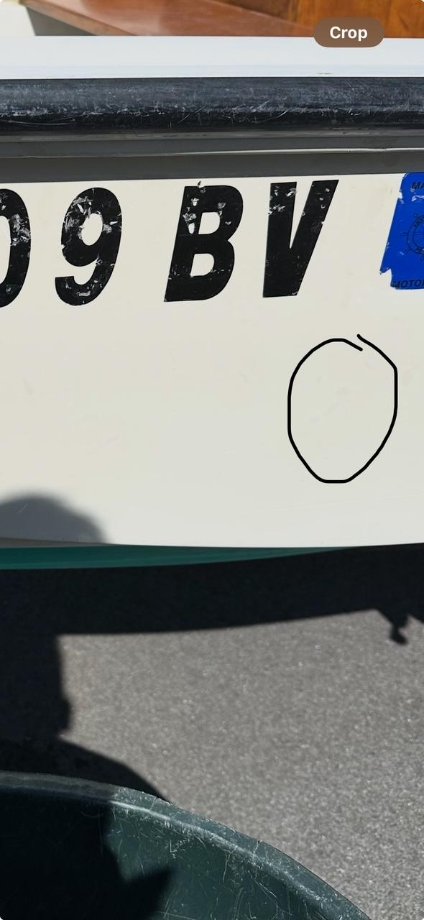

I added a photo and circled a desert tan repair

[Below in Figure 1 is a photograph of the hull color of the boat under discussion.]
Fig. 1. Photograph of hull color. The area inside the drawn-on circle is a repair made with Spectrum Patch Kit color DESERT TAN.

Judging a color from a photograph being viewed on a monitor with a browser is a rather inexact method, as there are many variables in the process. However, in the image seen above in Figure 1, the hull color does look like a typical Desert Tan gel coat finish
I do not see any particularly distinct different between the area inside the drawn-on circle and the rest of the hull. The hue or saturation or lustre differences may be too small to be perceived in the photograph.

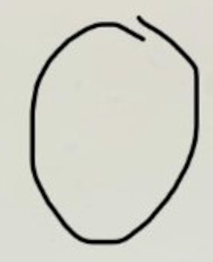

To better illustrate, I modified the image in the following manner:
  • a section of the hull color was copied from outside the drawn-on circle;
  • that portion of the photograph was then pasted into the middle of the drawn-on circle area; and
  • the remainder of the photograph was cropped away so only the drawn-on circle portion remained.
Figure 2 (below) below shows the image that resulted.
Fig. 2. A portion of the original image from Figure 1 where a rectangular cut-out of the original hull color images has been pasted inside the drawn-on circle in the center of the that circle as a means of comparing the two colors.
Again, I cannot see any difference in the color of the two portions of the hull.

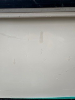

bad picture posted. Maybe the original hull has faded to 'white' more than the original desert tan. i've posted here a better shot of those spectrum touch ups that didn't match.
desert sand vs. gel coat.jpg (8.37 KiB) Viewed 3518 times

Postby msteinkampf » Tue Apr 15, 2025 9:18 am
I used the Spectrum Desert Sand paste product on my 1990 Montauk 17 in four places. In three places, the color match was perfect. In the fourth spot, on the side of the hull about where your patch is, the repair paste was a bit darker. I'm just living with the imperfection, but if you want a perfect match, I think you will need to fine tune the color yourself with pigments marketed for coloring polyester resin.
