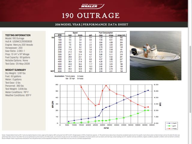

In 2004, The Outrage 19 was called the Nantucket. It was renamed Outrage 190 in 2006
http://continuouswave.com/whaler/cetacea/cetaceaPage71.html
The 2004 Nantucket weights the same (2050 lbs) as the 1998 Outrage 22 but is only 18'10 LOA.
The Nantucket has the Accutrack hull so it will have a better ride. While it was introduced with a 115hp engine, the current model offers a 150 or 200.
