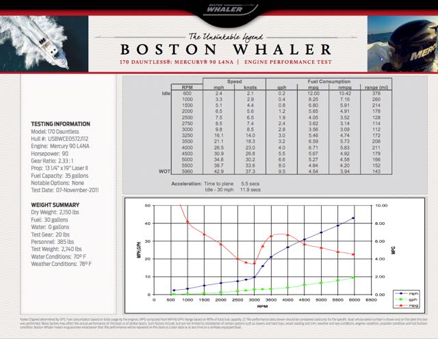

Boston Whaler does not supply 4 bladed props to any of its models.
The 2013 Dauntless 170 came from the factory with a 3 bladed Mercury Laser II 13 1/4 x 19. The performance report is attached.
I would guess the prior owner re-propped for tubing or carrying a full load.

Here is some clarification on what an engine that is called a Mercury 90-HP FOURSTROKE could be:
--the 90-HP FOURSTROKE based on the 1.596-liter Yamaha-made block with carburetors and no SmartCraft with 2.33:1 ratio, sold until c.2005
--the 90-HP FOURSTROKE based on the 1.596-liter Yamaha-made engine with fuel injection but no SmartCraft with 2.33:1 ratio, sold only briefly in c.2005
--the 90-HP FOURSTROKE based on the 1.7-liter non-supercharged VERADO block without DTS, (AKA the VERADITO) with 2.33:1 ratio, appeared c.2006
--the 90-HP FOURSTROKE based on a 2.1-liter block with smaller gear case with 2.07:1 ratio, appeared c.2014
--the 90-HP FOURSTROKE COMMAND THRUST based on a 2.1-liter block with larger gear case with 2.38:1 ratio, appeared c.2014
You probably have the Mercury 90-HP FOURSTROKE also known as the Veradito, or little Verado, because it used the same displacement four-cylinder in-line engine block as the small VERADO engines, but no forced induction from a supercharger. Its cowling has a little dome on top.
A boat from 2013 is right on the dividing line. Mercury was using the VERADO block based engines to make a 90-HP model for about eight years, then they developed another line of no-forced-induction engines that used much greater displacement. These engine were revealed in June 2014. Since your boat is a model-year 2013, it was most likely built before those larger displacement engines came out. So you've probably got the Veradito engine.
You should have the owner's manual for the engine, and in that literature you should be able to find the specifications about engine displacement. That will confirm the particular variant of the 90 FOURSTROKE you have. You will also find the gear ratio and the recommended full-throttle engine speed range. Since that Veradito engine is no longer made, it is hard to find that data on-line, so if you have it, please contribute it to the discussion so we can better understand the performance you are getting now. Going by the Boston Whaler test data, you can assume the gear ratio is 2.33 and the maximum engine speed is 6,000-RPM. In the test data the engine is shown to be making 6,000-RPM at full throttle. But reading it in the manual for the engine on your boat would confirm those inferences.
If your boat only gets to 5,200-RPM, you may not be taking full advantage of the engine. Often on a high-RPM engine with four-stroke-power-cycle, the engine keeps making more horsepower as engine RPM increases. To get all the power you can, you often have to select the propeller to let the engine accelerate right to its RPM limit.
