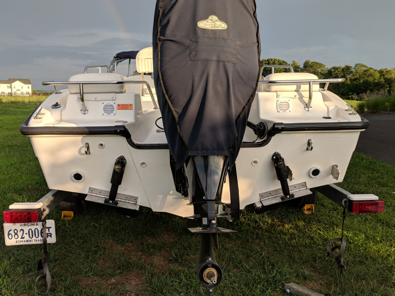

Re: Dauntless 16 performance
GoldenDaze wrote:Lenco has some narrow 4" trim tabs that *should* fit, just barely, inside the swim ladder. These are on my "do this someday" list
Now it's on my "almost done" list. I'll let you all know in a week or two how well they work.

Re: Dauntless 16 with Yamaha F100
Yes, I saw the thread about the Nantucket transom, and it led me to give my through-hulls a good inspection. Both the motor well drains were loose, as was the bilge drain. One of the cockpit drain transom fittings was loose and cracked at the base (great recipe for a sinking if it wasn't a Whaler) and both cockpit fittings were loose and leaking. Over the last week I've replaced everything but the bilge pump outlet, which is fine. 18 holes in the transom for the trim tabs excavated only bone-dry wood, so I thank all the contributors to that thread for the early warning!
Eagle1499, I've now had a chance to put about 25 hours on my 160 Dauntless since installing the Lenco 4x12" trim tabs. The results are fabulous! See my writeup at http://continuouswave.com/forum/viewtopic.php?f=6&t=3860. This upgrade was well worth the cost and effort!
