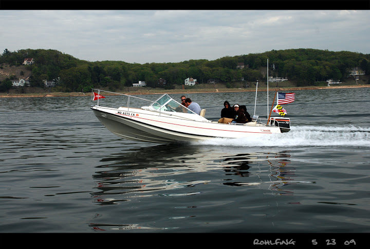

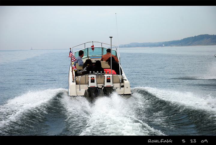

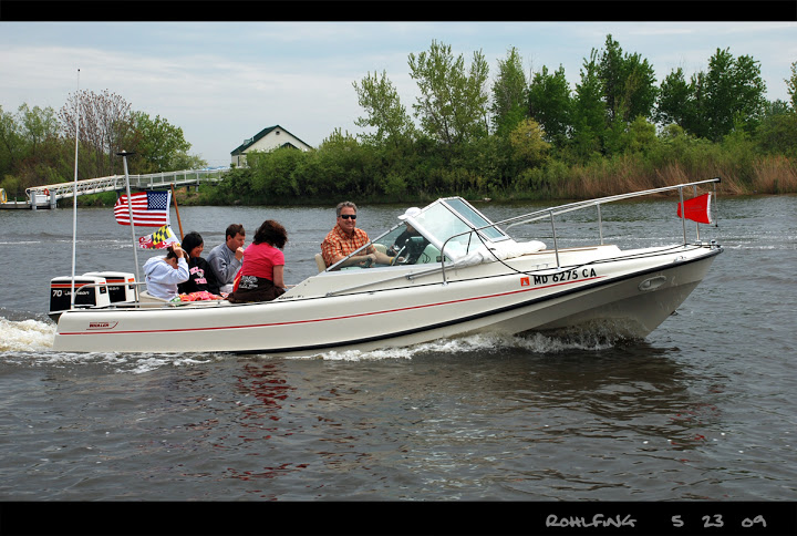

Jim Dunlap (Jimd on the old forum) has a 1976 21 Revenge with twin 1976 70hp Johnsons. Both are standard rotation and he has done a lot of work to settle out the right mounting heights and has done a fair bit of propeller testing. I know he recently settled a set of Stiletto Stainless Props, but I can not find what size and pitch they were.
The boat performs very well with these motors and tops out in the high 30's.
