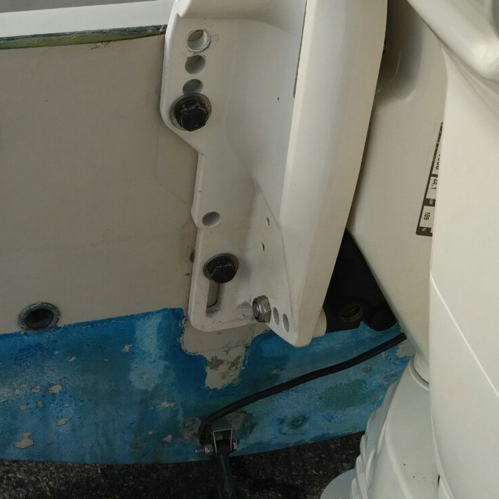

OK, it is the time of year that I am once again thinking that there is more juice in my boat than my current mounting arrangements are allowing for.
I have created a video of my engine running at full throttle at it's current mounting height (https://youtu.be/2uNWmN0M8RI)
Any feedback on the current engine running height is appreciated.
You can see that moving the motor up or down will require some epoxy work and drilling of holes in the proper location from this image. The top hole should be a bit higher, and the bottom one should be lower. I'm willing to do the work, just wondering if any one thinks it will be worth it.
Thank you.
Drewread

Postby jimh » Tue Aug 14, 2018 11:06 am
Due to the camera lens getting some spray, the position of the anti-ventilation plate is not in sharp focus in your nice recording. As best I can tell, it looks like the engine mounting height could be raised more, as the AV-Plate seems to be still running under the water.
As for the present location of the engine mounting holes, I agree with your comments: the upper pair of mounting holes appears to have been located too far below the top of the transom. The usual location for the upper mounting hole pair according to ABYC recommendation is given in the FAQ. See
Q9: What is the Standard Transom Hole Layout?
http://continuouswave.com/whaler/reference/FAQ/#Q9
The holes in the transom should be 1 and 7/8-inch below the top of the transom....but not less than 1-3/4-inches...
Using the hole spacing as a reference, the upper hole pair on your boat looks like it was drilled at least 2 and 5/8-inches below the transom. This means the upper holes are too low by about 2-5/8 - 1-7/8 = 6/8 or 3/4-inch or "one-hole."
Since your engine is mounted three-holes up and the mounting holes are the equivalent of "one-hole" down, the effective engine height now is two-holes-up from lowest, if describing it as if the transom holes were normally located.
The problem now is to know in advance if all the work of plugging the existing upper holes and drilling new ones will be worth the time and effort, that is, will being able to raise the engine to the maximum three-holes-up mounting height bring about a marked improvement. That is hard to say. I'd go boating and have some fun with the boat for a while before taking on all that extra work.

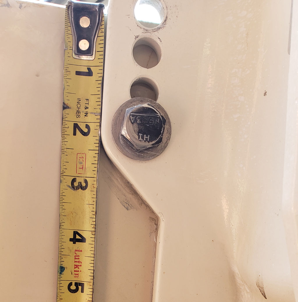

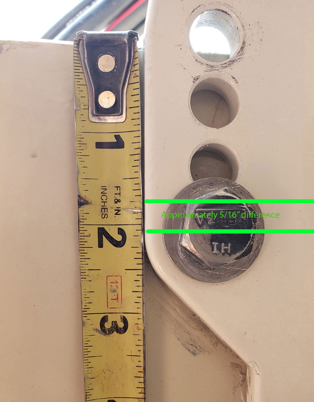

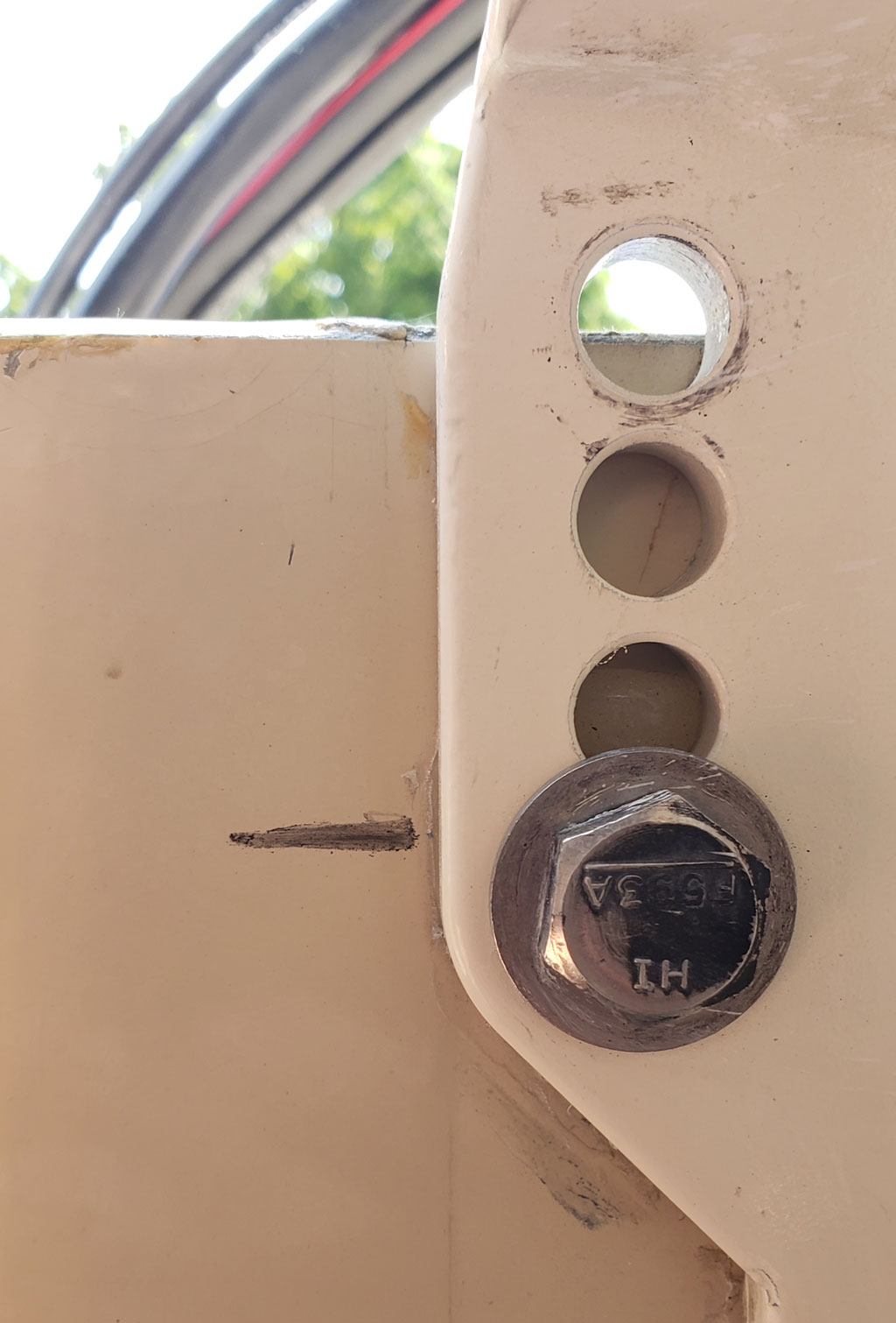

Yea, the camera took some spray.. I don't think it would ever stay dry back there, but as you said you get the idea from what you can see. The anti-cav plate is below the water - probably an inch or two. Pretty hard to get back there and measure accurately while driving under WOT in a 15' Whaler as you well know... ;)
I took some more accurate pictures today with a tape measure and a pencil from almost straight on.
Although it is hard to get an exact measurement (there is some lens distortion due to various angles here) it is somewhere between 5/16" and 3/8" too low, dependent on the angle of the transom, tape, camera and/or your eyeball. I'm of the opinion that it is around 3/8" out of place. Like I said, it is a lot of work to get it up 3/8" and I am busy enjoying it as is right now. I'm just seeking advice for future tweaking.
The top of the pencil line is at exactly 1-7/8" in this photograph.
I have tried adding weight forward to counter any problems with the additional weight from the newer engine. I have added a trolling motor to the bow as well as a rather heavy Group 31 battery under the front bench on the port side. I have also moved a few hundred pounds of crew around the boat many times, on many a trip, to see if I could get the weight change to counter the porpoising and no luck. I still get porpoising when hitting top speed at optimum RPM no matter where I move that weight.
My current thinking has me thinking that maybe the prop is not getting up to RPM unless I trim it up too high, which is causing the porpoising, and that perhaps I should be trying a new propeller to get the RPMs up instead of relying on trim to get up there to the sweet spot.
Based on Phil's recommendation (thank you) of the 13-7/8" x 21" Viper propeller do you think that would achieve the increased RPM without trimming up as much?
Thank you both for your input.

Postby drewread » Wed Aug 22, 2018 7:29 pm
I'd have to epoxy (with filler) the upper holes anyway, as I would be drilling through a portion of the hole anyway :)
flymo
Posts: 189
Re: 15' SSL Re-power E-TEC 60
Postby flymo » Thu Aug 23, 2018 5:58 am
OK, finally had time to read the full thread. Seems like you're still having porpoising problems, you're hitting 5850 RPM when running light, and you have a basic 19-pitch aluminum prop.
One cause of porpoising is the motor being mounted too low. So while it may not make a lot of difference, redrilling and going up the equivalent of one hole might help. I'd work on the prop first, though. You definitely want a quality stainless prop to get the most from your motor.
I can't tell the characteristics of the prop you have on there (the link you posted just goes to a generic page) but I'd be inclined to go to a prop with less rake and thus more stern lift, and to drop down an inch in pitch. That should help the porpoising and let you get up to speed without as much trim. I don't think I'd stress too much about blade area - the eTecs have a wide torque band.
I had good luck contacting PowerTech and getting a recommendation from them, which worked out well for me. Most of their props are available in 1 inch pitch increments, unlike other manufacturers, so you can fine tune the WOT RPM.
It takes some work to find the perfect prop - I'm on prop #5 and I think I'm done, but you never know.
