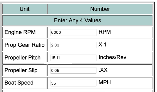

Simon -
Look for these sizes
13.25x15 PowerTech SCP
13.25x15 Yamaha Performance Series
13.25x15 Turbo 1
13x17 Yamaha Painted Stainless Steel
This is the results from the prop size calculator.
Screen Shot 2021-03-31 at 2.45.47 PM.png (25.36 KiB) Viewed 5062 times
