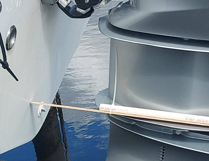

Recently I re-powered my 2008 240 OUTRAGE with a Mercury VERADO 30-HP V8 engine, but I am not sure the engine mounting is at the best height. My concern is the engine mounting may be too high, particularly when compared to the original V6 engine mounting height.
FOR READERS WHO HAVE MOUNTED A MERCURY 300-HP V8 ENGINE ON A 240 OUTRAGE:
Tell me your experience with engine mounting height.
Figure 1. Close-up of engine Anti-Ventilation plate with an extension to show the relationship of the AV plate to the transom and keel.

I do not have any experience with mounting a Mercury VERADO V8 300-HP engine on any boat, and thus not able to offer you any first-hand advice regarding what mounting height should be used on your 2008 240 OUTRAGE boat. But I do not think there is anything about the combination of your boat and engine that would change the general considerations of engine mounting height, so I will offer the following advice.
Typically for optimum performance when the boat is on plane at typical planing speed and the engine is trimmed for that speed and operation, the position of the engine Anti-Ventilation (A-V) plate relative to the flow of water around the engine gear case should be such that the A-V plate is just at or just above the waterline.
The best way for readers to pass judgement on the mounting height of a particular engine on a particular boat is for the boat operator to provide a photograph that shows the relationship of the A-V plate to the water flow when the boat is on plane and at the typical planing speeds, or perhaps in the upper range of planing speeds.

But assessing engine mounting height from an illustration such as seen in Figure 1 is really not possible.
