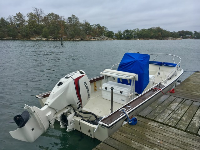

Thanks, both, for your replies and apologies for the delay. After tinkering a bit further, I decided now was a good time to just repower with a new 150 E-TEC G1. BRP had a decent promotion and I got a pretty good price from my local dealer. I chose not to go with the "H.O." model because the specs are identical at the 150 hp level and no one could give me a good enough reason to do otherwise. I also chose not to go with the G2 because it's a bit heavier, due largely to the new mounting bracket (which apparently can be swapped out for the traditional bracket), and I just couldn't envision it aesthetically sitting on my transom. I chose the standard analog gauges, but added a SIMRAD NNS7 evo2 connected to the motor via a NMEA 2000 backbone for digital details.
So far top speed is 44-45 mph (GPS) with standard 14.25x17" aluminum prop, 60 gallons of gas (370 lbs.), general gear (about 100 lbs.), and one operator (about 160 lbs.). I am also still in the initial phase where the motor really drinks up the XD-100, so the gasoline:oil ratio should improve. My time to plane can be measured in fractions of a second. The motor is mounted one hole up, which seems okay with this prop, especially in higher-speed turns when trimmed out, but suggestions as to re-mounting and re-propping are welcome. It is very, very quiet at idle. I've used it for only a few hours, but so far I am very pleased with the performance of this motor.
FullSizeRender (1).jpg (108.69 KiB) Viewed 12417 times
Re: Outrage 18 with 2016 E-TEC 150
Postby jimh » Mon Oct 03, 2016 4:00 pm
Thanks for the update and the images of the new E-TEC 150-HP engine on the classic OUTRAGE 18 boat. The two look very good together, and your performance information indicates the two work very well together.

Nice looking combination. It would be worth it to invest in a stainless steel propeller. Check here on what others have used but the BRP Rebel may be a good choice in the same pitch as the alumimum you have now.
ASIDE: photo shows good location for fender
Postby jimh » Wed Oct 05, 2016 11:56 am
Also note the position of the forward fender; it is in just the right place for a classic hull.

Thanks for the kind remarks and advice on prop selection. I am going to go stainless for next season, and will keep the current prop on board as a spare. I have been considering the Rebel and the Viper. The forward fender is attached to the bow railing using a Taylor Made Rail Fender Hanger, purchased at West Marine, which so far has worked well.

Re: Outrage 18 with 1989 Johnson 120; E-TEC 150-HP Re-power
Postby Phil T » Mon Oct 17, 2016 9:45 am
Appears the motor can be raised at least 1 if not 2 holes.
The consensus from Boston Whaler owners mounting E-TEC outboard engines is to mount them as high as practical.
