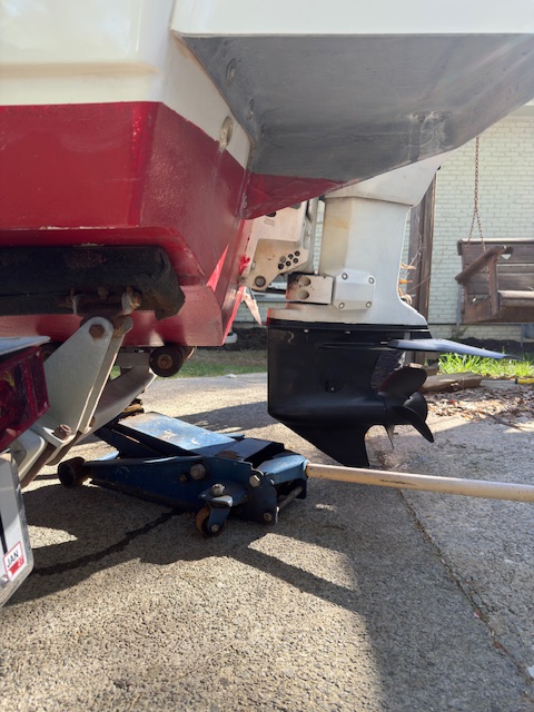

I have a 1995 Dauntless 17 with a 1995 Johnson 115 OceanRunner model J115SLEOC. [The gear ratio is 2.00:1] [The engine is mounted two-holes-up.]
I need help with what seems like high propeller slip.
DATA for PROP 3 (see below)
RPM = 5500
RATIO = 2
PITCH = 17
MPH = 32
SLIP = 27
Fig. 1. Gear case.
IMG_1365 (1).JPG (140.78 KiB) Viewed 31165 times

Figure 1 shows what may be a 25-inch shaft engine on a 20-inch transom. Give the entire model designation of the engine, which will contain the code for shaft length of the engine.
About all I can infer from the one data set is to agree that the Propeller 3 as tested shows excessive SLIP. This could be due to excessive outward trim.
When the engine is of the proper shaft length for the boat transom height and is mounted one-hole-up or higher, when the engine trim is set so the anti-ventilation plate is parallel to the water, and when the upper surface of the anti-ventilation plate is just at or just above the water that flows past the gear case, then the engine mounting height and engine trim-out are in the proper positions.

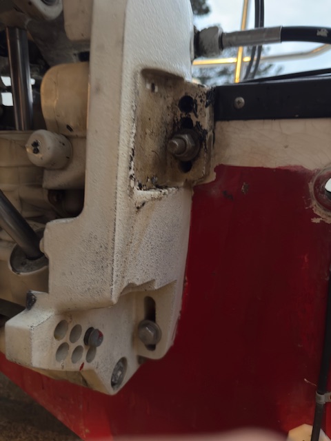

I used the wrong original phrasing but can confirm the motor is mounted two-holes-up.
Fig. 2. Detail of engine height nmounting position.

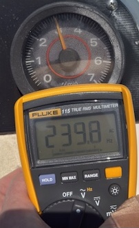

Check the tachometer calibration. If the tachometer reading is not accurate, then the engine speed could be slower than indicated. Using an incorrect value for engine speed will cause the value for SLIP that is calculated to be incorrect.

Thank you for recommending tachometer calibration. I had an opportunity to get on the water today and confirmed that my tachometer is the problem.
When the tachometer showed 5,500 RPM, the multimeter measured the stator pulse at 475-Hz. If the 6 pulses per revolution conversion chart is correct for my engine, the actual engine speed is 4,750 RPM while the tachometer was showing 5,500 RPM. The tachometer is reading about 14-percent higher than the measured stator Hz converted to RPM.

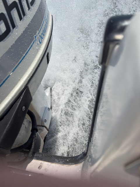

I briefly attempted to reach top speed using the multimeter and watching for 550 Hz (5,500 RPM). I got close to 540 Hz and reached 36 MPH with my normal load (wife, dog, full gas tank). The corrected propeller SLIP is then 16.3-percent.
It was windy and water conditions were rough today. My trim was not optimized for the top speed run.
Fig. 3. The position of the AV-plate at 30-MPH: completely buried.
Q1: Would you recommend I raise the motor up one more hole, to three-holes-up?
Tachometer Calibration Test Method
Fig. 4. A meter being held by a hand near a dashboard.
Connected multimeter alligator clip leads to the "PUL" and "GND" studs on the gauge. The multimeter set to measure stator pulse in Hz. I found a 6 pulse per engine revolution to RPM conversion chart. I ran the engine at different RPM speeds on the tachometer and recorded the multimeter Hz values. If the tachometer was properly calibrated or functioning correctly, the multimeter should measure 300 Hz at 3000 RPM for my 6 pulse per engine revolution motor.
RPM = (Hz x 60)/PPR = (Hz x 60)/6 = Hz x 10
(239.8 Hz x 60) /6 = 2,398 RPM is what my multimeter measured. My tachometer showed 3000 RPM. That is how I confirmed that my tachometer is reading improperly. I will now look at the selector switch on the back of my tachometer to confirm it is set at 6P and not at one of the other settings such as (5P, 4P, 3P, or 2P,). If my tachometer selector switch was improperly set to 5P, it would match the deviation from the multimeter measurement. I will confirm when I return to the boat in storage. If the tachometer selector switch is set to 6P, I will replace the tachometer.
I would recommend using a chart that matches your outboard PPR at various RPM ranges to minimize mistakes and make life easier.

My advice:
  • remove the foil appendage from the AV Plate;
  • raise the engine at least one hole higher;
  • explain to readers what is being illustrated in Figure 4.

I will attempt to raise the motor to three-holes-up, which will be highest position possible with the current engine and transom setup. I will remove the foil appendage from the AV plate and retest to see how the boat handles.
I do not expect that the engine raised to three-holes-up will be high enough for optimal AV plate position in the water.
I am curious how others with my model 1995 Dauntless 17 have setup their engine.
Visually to me, the upper engine mounting holes on the transom look like they are lower [than the recommended layout].
I found descriptions that the 1995-1996 Dauntless 17 had a 20 inch transom and in 1997 Dauntless 17 had a 25 inch transom.

RobertB3 wrote:Visually to me, the upper engine mounting holes on the transom look like they are lower [than the recommended layout].
The centerline of the upper set of engine mounting holes on the boat transom according to the BIA standard recommendation should be 1-7/8-inch below the top of the transom.
More details are given in
FAQ: Q9: What is the standard transom hole layout?
https://continuouswave.com/whaler/reference/FAQ/#Q9
Also there is a useful diagram showing BIA standard hole layout at
Transom Engine Mounting Hole Layout
https://continuouswave.com/forum/viewto ... f=7&t=5808
If the engine mounting hole positions on your boat were drilled lower than recommended, the next option may be to use a short jack plate to raise the engine higher.
I also wonder if the SEI aftermarket gear case might be somewhat longer than the OEM gear case, also contributing to your lower-than-optimum overall engine mounting height.
