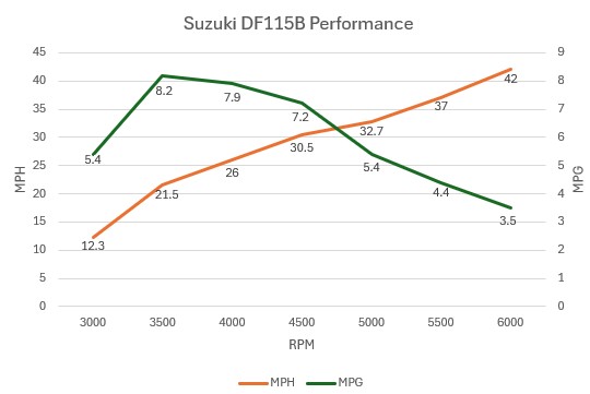

Now that I had a working gauge with shiny new features I was eager to look at some statistics. I set the gauge to view instantaneous fuel economy, and tested various engine and boat speed combinations.
Fig. 1. Boat Speed and Fuel Economy as a function of Engine Speed
I recorded values at 500-RPM engine speed increments from 3000 to 6000-RPM. The boat gets on plane around 3,100-RPM, so there is a big spike in MPG at that point. The data was taken on the Mississippi River by averaging engine speeds and boat speeds from upstream and downstream test runs. There is probably some small variance in boat speed and MPG based on the river current at the specific spot the reading was taken. An engine speed of 4500-RPM seems to be a nice sweet spot for MPH and MPG: 30-MPH and 7.2-MPG.

With the new information of the engine gear ratio, and using the propeller pitch as 21, the SLIP can be computed from the graph data points for engine speed and boat speed:
RPM    MPH     SLIP
3000 12.3 46.6
3500 21.5 20.0
4000 26.0 15.3
4500 30.5 11.7
5000 32.7 14.8
5500 37.0 12.4
6000 42.0 8.8
With the SLIP value under 10 at maximum boat speed, the propeller is performing well. That the SLIP values increase above 4500 RPM is a bit odd. Perhaps the trim setting was adjusted to be further trimmed out at those higher engine speeds. This would account for the increase in SLIP.
