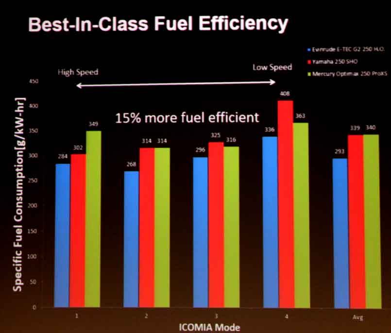

During the dealer meeting in 2014 when Evinrude revealed their new E-TEC V6 74-degree engine, a slide was presented that showed the brake specific fuel consumption of the new engine at various loads. The slide looked like this:
In this bar graph presentation, a lower bar is the better value, as the data is for rate of fuel consumption, and lower fuel consumption is better. (Note that the legends "High Speed" and "Low Speed" are reversed in this slide from the actual speeds.)
This is a very interesting slide because it gives the exact data values for each bar on the graph. Let us concentrate for the moment only on the E-TEC G2 or 74-degree V6 engine data, and extract the data from the slide.
Specific Fuel Consumption in grams/kW-hour
E-TEC G2 250 H.O.
MODE 1 = 284
MODE 2 = 268
MODE 3 = 296
MODE 4 = 336
AVERAGE= 293

The illustration says the "average" is 293. Let's see if we can come up with that number and find the missing MODE 5 data.
The proper weighting method is to apply the fuel consumption according to the time weighting, so we would have:
284 x .4 = 113.6
268 x .25 = 67
296 x 0.15 = 44.4
336 x 0.14 = 47.04
TOTAL = 272.04
If the "average" is from weighted ICOMIA factors, then to boost 272.04 to a composite weighted average of 293, the missing factor would have to contribute 20.96 to the total. Since that is weighted at only 0.06, the missing data would then have to be
20.96 / 0.06 = 349.3
That seems like a very reasonable factor for fuel consumption at full throttle because it is consistent with the values and trends at lower throttle setting, that is the fuel consumption is tending to increase with increasing throttle. We can then make a reasonable assumption that the E-TEC G2 250 H.O. fuel consumption for all five ICOMIA modes would look like this:
E-TEC G2 250 H.O.
MODE 1 = 284
MODE 2 = 268
MODE 3 = 296
MODE 4 = 336
MODE 5 = 349
AVERAGE= 293

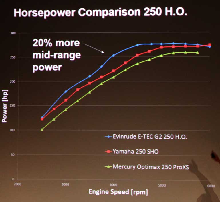

There is an old standard for a rule of thumb for estimating outboard engine fuel consumption, dating back to the days of the conventional two-cycle outboard engine with carburetors, that says the fuel consumption at full throttle in gallons-per-hour will be the horsepower divided by ten. For example, a 250-HP engine would consume 25-GPH at full throttle. With the data on the E-TEC 74-degree V6 engine rated as a 250 high-output engine, we also got a slide giving us a graph of horsepower at various engine speeds.
Horsepower as function of engine speed ; shown at E-TEC G2 reveal

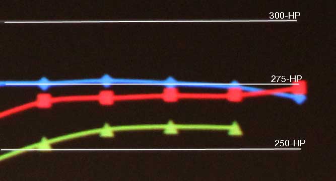

In this graph the data values are not given, so we have to interpolate between the Y-axis lines to get the horsepower. To make this easier, I have made an enlargement and added a line at 275-HP.
Detail of horsepower between 5,000 and 6,000-RPM
We can see that the E-TEC 250 H.O. 74-degree V6 engine is making 275-HP. Since we know its fuel consumption (from the other slide) we can make a new rule of thumb for modern engine fuel consumption, based on this data. We take the horsepower value and use it to get a fuel consumption rate. We figure that gasoline weighs 6.25-lbs-gallon, and we use the MODE 5 specific fuel consumption data:
0.573-lbs/HP-hour x 1-gallon/6.25-lbs x 275-HP = 25-GPH
For the rule of thumb factor:
275-HP / 25-GPH = 10.9 rounded up to 11
Now we have a simple rule of thumb for fuel consumption of modern outboard engines at full throttle: divide HP by 11 to get GPH
