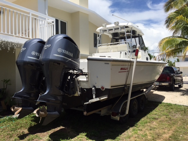

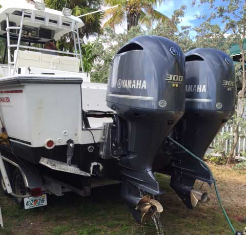

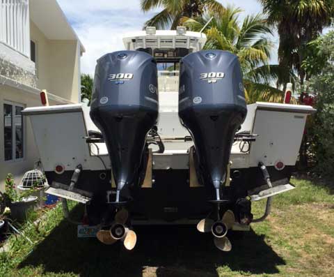

Jackplates Installed
- IMG_8558crop.jpg (27.98 KiB) Viewed 28364 times
- IMG_8568crop.jpg (32.16 KiB) Viewed 28370 times
- IMG_8559.JPG (124.49 KiB) Viewed 28415 times

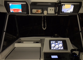

Garmin Chartplotters installed
Re: Offshore 27 Re-power with Twin Yamaha F300 4.2L
Really nice - thanks for the pics!
