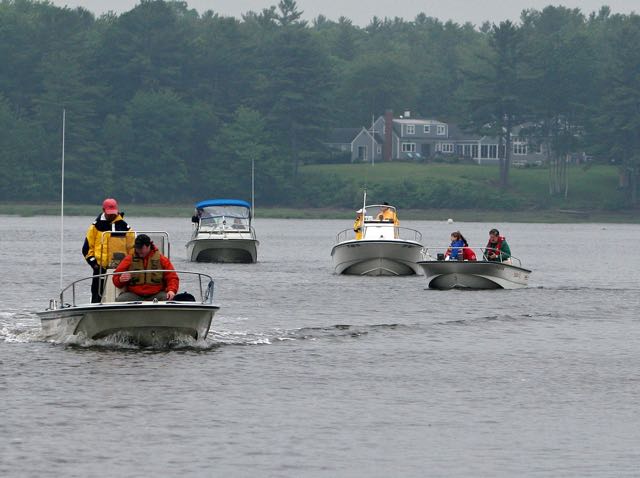

As a former owner of a 1991 model year and a new owner of a 1992, here is some additional information.
The Outrage 17 I built from 1990-1995 is has a maximum horsepower rating of 120hp. This comes from the actual capacity plate on the boat.
A 115 hp motor with a light load will produce a wide open throttle (WOT) speed of 45mph. Even on calm seas, higher speeds are risky. Where can one cruise at 40 mph for long periods of time?
This model has some unique characteristics that include being sensitive to stern engine weight. I personally don't recommend anything higher than 400 lbs.
This model is also sensitive to bow weight. 2 adults in the bow result in a observable bow down attitude while at headway speeds. On plane is not a problem provided proper engine trim is selected. Below is a photo with myself and my friend Matt (CatBoatSailor) during the Piscatisqua River gathering.
Note there is just the two of us, 50 lbs gear, full tank of fuel.
