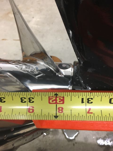

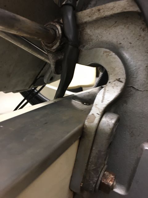

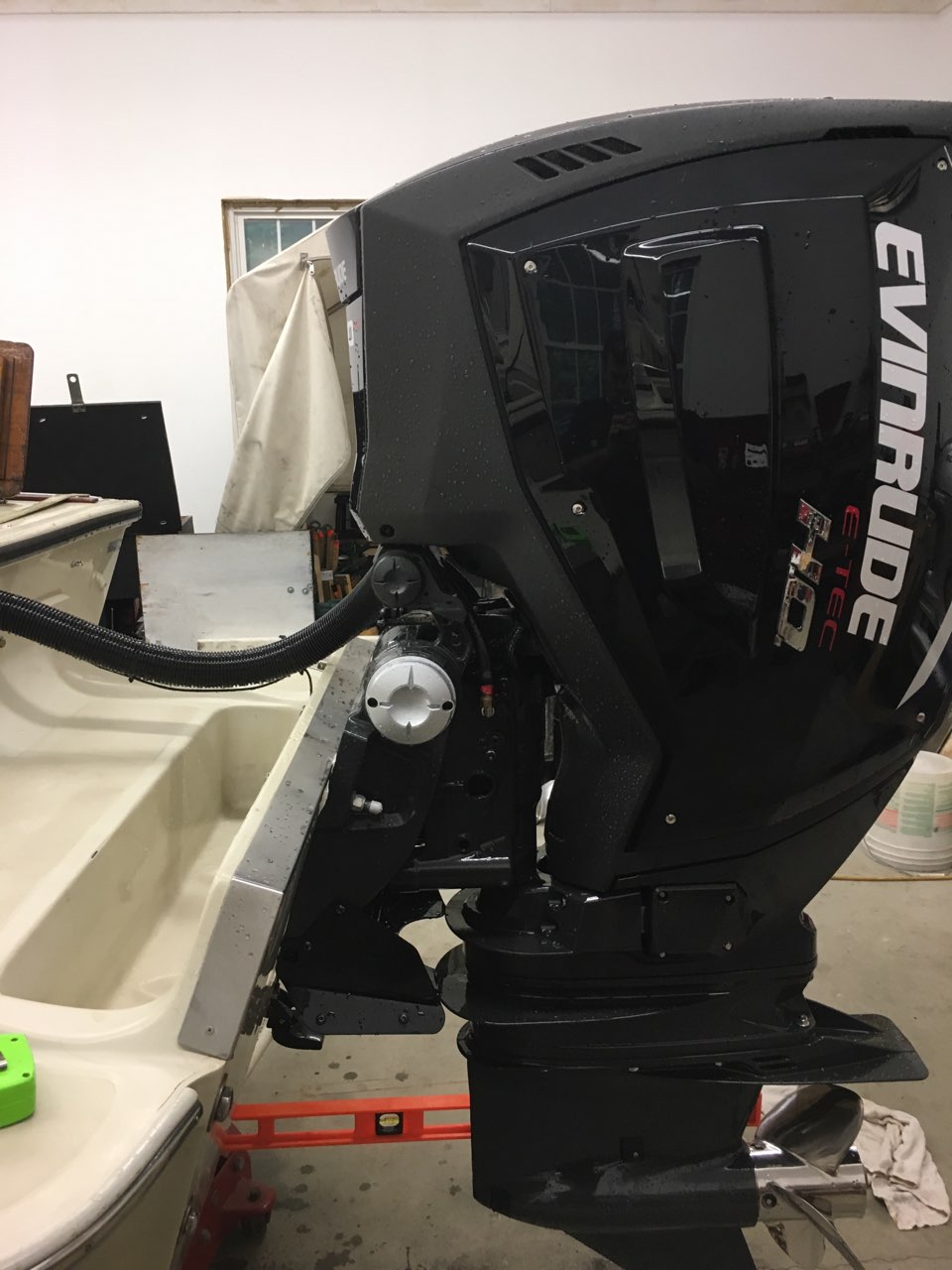

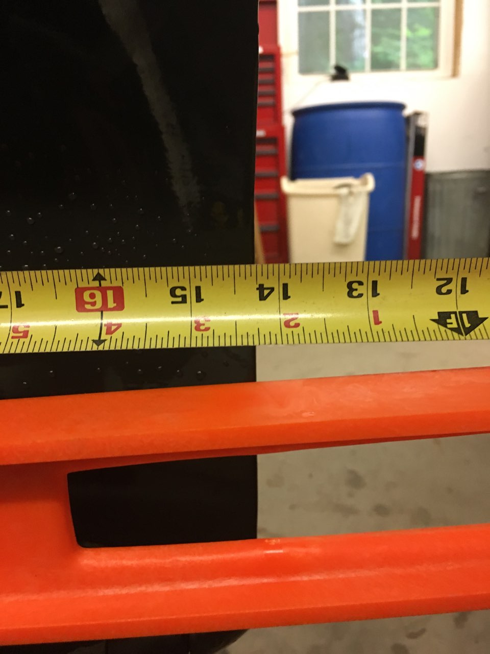

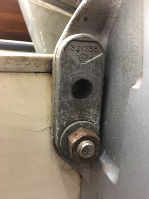

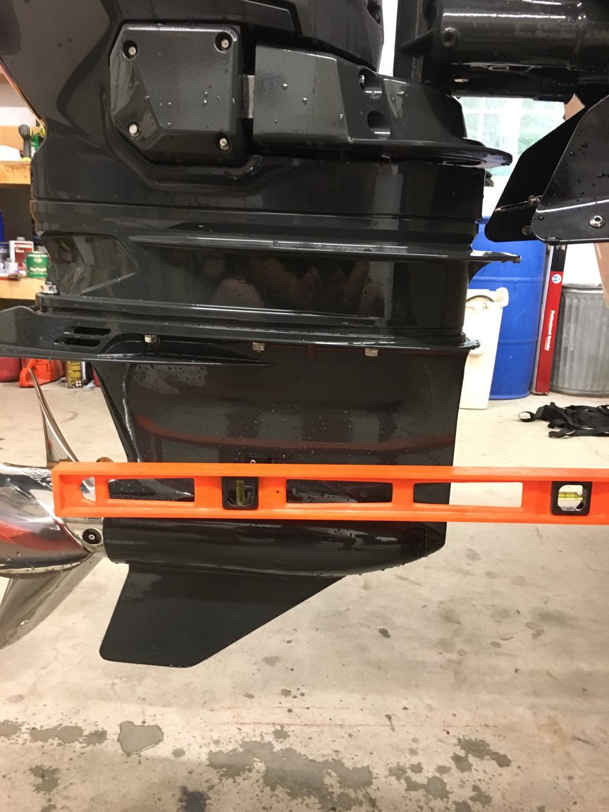

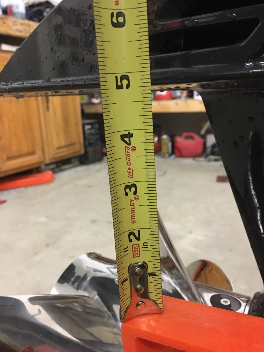

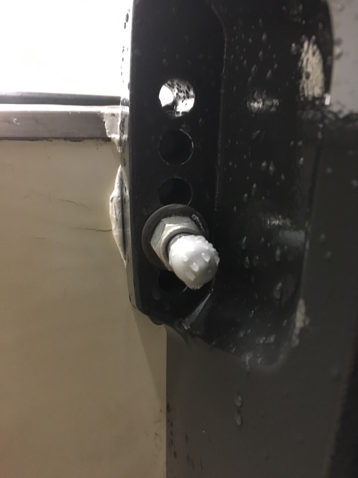

Re: OUTRAGE 22 Whaler Drive, E-TEC G2 225 H.O.
Postby Phil T » Tue Jul 03, 2018 11:16 am
From Bruce:
I took a couple comparable pictures to show the difference in the set up and rigging. The pictures of the old motor are during the derigging so some of the cables are messier than usual but the contrast is stark.
Old Mounting:
I also took some pictures with the motor trimmed so that the A/V plate was parallel to the bottom of the whaler drive. In those photos I have a level with the top edge held tight to the bottom of the whaler drive with a floor jack. I took a picture showing the height of the A/V plate elevation above the hull 4.75” also a measurement to the leading edge of the gear case from the transom of the whaler drive 14.25”. And another from the transom of the whaler drive to the leading edge of the prop a little over 31.5”
Measurements:
The picture of the mounting bolt pattern did not come out as good as I would have liked it is like this:
O
O
O
O bolt in this hole yes there are 5 holes the top hole in the picture is above the transom you can see light through it!
O
Mounting height:
New Motor - Side view
The motor was a pleasure to drive the DTS and power steering were incredible. Hole shot was amazing and I have the wrong prop ( swapping tomorrow ) to lower pitch. I can’t wait to get this dialed in, already 4 MPH faster and I think there is some room left. I also burned about half the fuel that I normally would on our 4 day camping /fishing trip. I did not take detailed measurements because of the prop swap.

The E-TEC G2 225 H.O. engine shown above is mounted three-holes-up on the Outrage 22 Whaler Drive boat.
The performance data reported so far
BOAT = Outrage 22 Whaler Drive, two adults, 60-gallons fuel
With Evinrude RX4 18-pitch:
5,310-RPM produced boat speed of 46.5-MPH, boat porpoising; engine trimmed out; calculated SLIP = 5

My comments: the low value for SLIP (5) indicated for the RX4 shows the mounting height is not too high for that propeller. The SLIP value for the CYCLONE (9) shows it is running a bit high, perhaps, but probably typical for aerated water behind a Whaler Drive.
Try a REBEL TBX 17-pitch (PN 763986) or 16-pitch RX4 (PN 177340)
