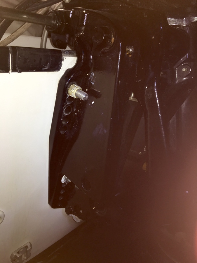

Postby johnlandnsea » Wed Feb 24, 2016 4:20 pm
Phil,
At WOT I was running 5800 RPMs. Here's a pic of the engine mount height...
"Me upon my pony, on my boat"~Lyle Lovett
Re: 170 MONTAUK Re-power with 115-HP Mercury Command Thrust
Postby Phil T » Wed Feb 24, 2016 4:52 pm
The motor is mounted all the way down, I would raise it 2 holes. You will gain approximately 125 rpm for each hole you go up due to less drag.
Raising the motor is doable as a DIY with basic tools if the boat is on the trailer and you have a friend to help.
Postby johnlandnsea » Sun Feb 28, 2016 8:59 pm
Thanks Tim. Sounds like I need to raise my engine one or two holes.
