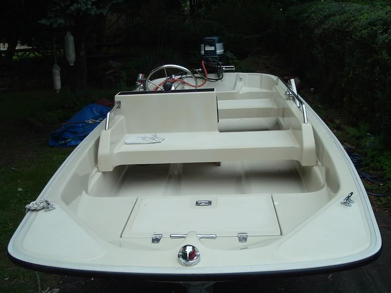

I have a 1989 13-foot Boston Whaler [later identified as a 13 GLS] with side console and throttle. It is currently powered by a 40-HP four-stroke-cycle engine. Our state law permits a 13-year-old to drive a boat powered by an engine of less than 10-HP. My daughter is about to turn 13. I want to re-power the Whaler with a 9.9 HP four-stroke-cycle engine. I appreciate it will have limited performance. We live on a lake, and it would be pretty cool for her and my two other kids (when they are of age) to safely putt-around in the boat. I believe the life lessons associated with it would be great.
Does anyone have any experience with [the performance of a Boston Whaler 13 GLS powered with a 9.9-HP engine]?
If I purchase a 9.9 HP long shaft engine, where would be my best bet to purchase?
Should I purchase new since I will have it for the next seven years?
Any advice is appreciated. Thank you for all your help. Brian

You technically have a Boston Whaler 13 GLS Boston Whaler. The "130" designator is used for the new 130 hull, which is different. The GLS is heavier than the SPORT as well. The minimum power that will [give] satisfactory performance with a light load is 9-HP. I have been in 13-foot tiller-steered boats with 15-HP, and they [are] fine, [reaching] just over 20-MPH. Maybe someone can chime in with this combination.
I would guess [maximum boat speed will be in the] high teens, but speed is going to be really sensitive to weight. The heavier interior and 9.9-HP might make this a boat [that can reach plane with no more than one adult aboard]. The outboard engine is going to be running at or near wide-open throttle a lot of the time. The usage of your Whaler maybe really limited or may become the kid's boat.
