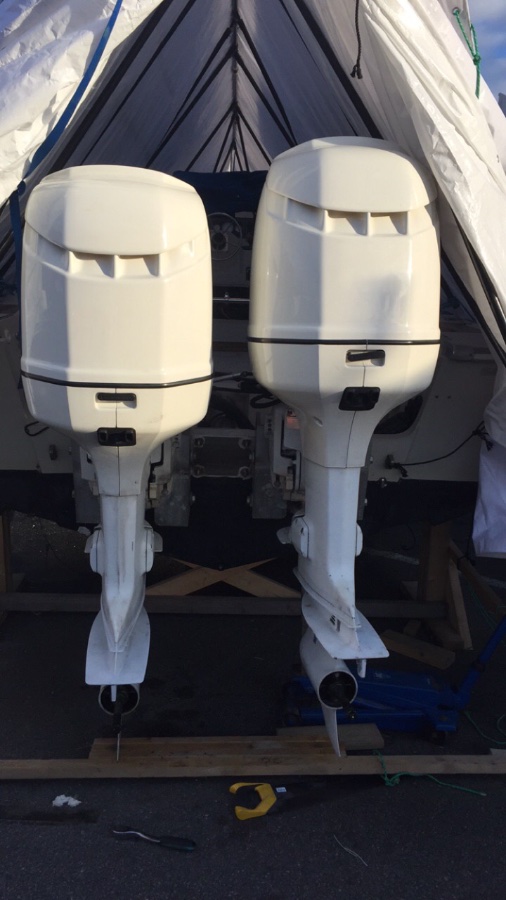

Hi, sorry for the late utdate. Due to some problems and very busy at work, this season has started very slow and late. I raised the motors all the way up (might have to lower it a bit since it looses grip when going on plane and in hard turns). Cavitation plates are dry on the outside and gets little splashing on the inboard side. The new bravo 1 22p helped, but I'm still not getting the rpms I would like. I'm now getting 49-50 knots on gps, but only 5100-5200 rpms with light load. This seems like very good slip numbers and definitely much better then I was told to expect from Bravo 1 props. I'm happy with the speed, but would like to be closer to 6000 rpms with light load. Acceleration is very good. I'm gonna do a decarb and change plugs, but I'm afraid this isn't enough. Plugs are almost new, but don't know when it was decarbed last time.
Re: Outrage 25 Twin Evinrude 250

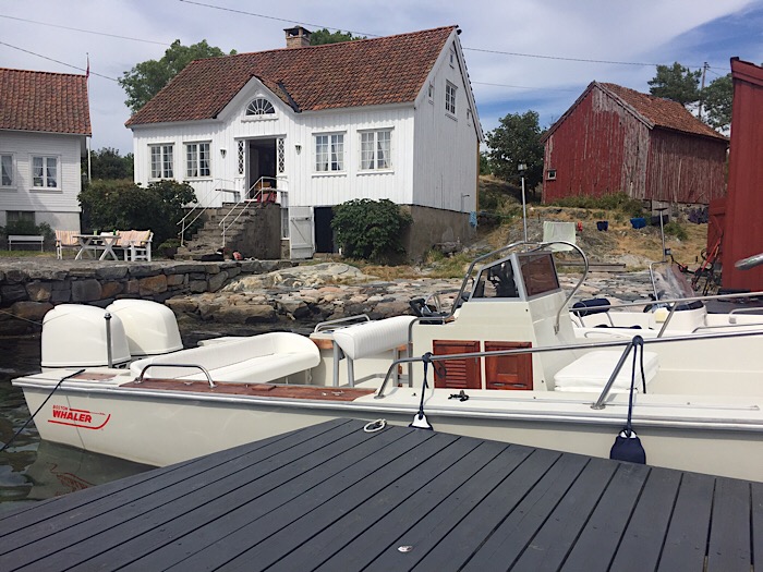

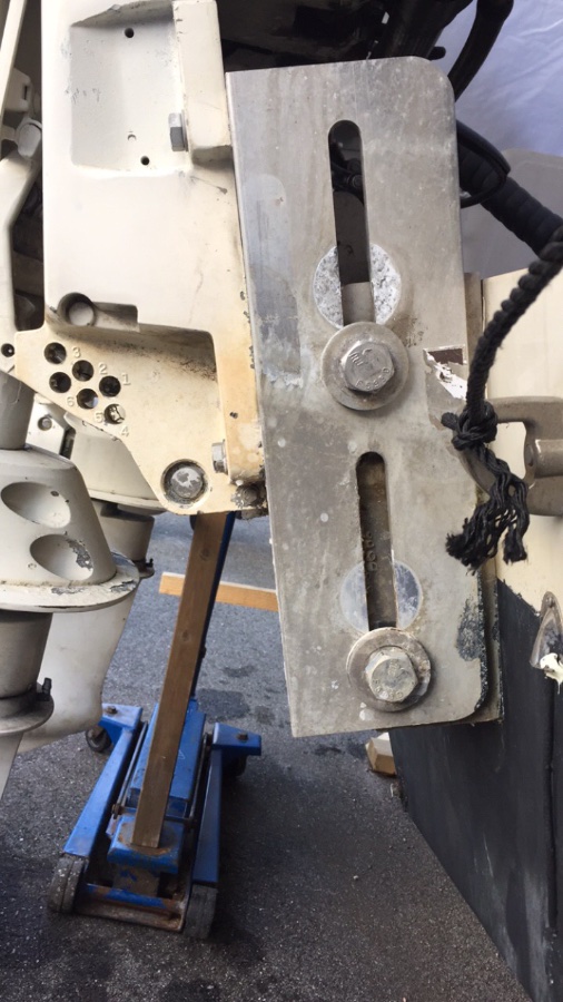

Some pictures.
- IMG_3338.JPG (179.33 KiB) Viewed 17831 times
- IMG_3206.JPG (167.47 KiB) Viewed 17831 times
- The picture lie a little since it's not trimmed equally
- IMG_3204.JPG (127.85 KiB) Viewed 17831 times

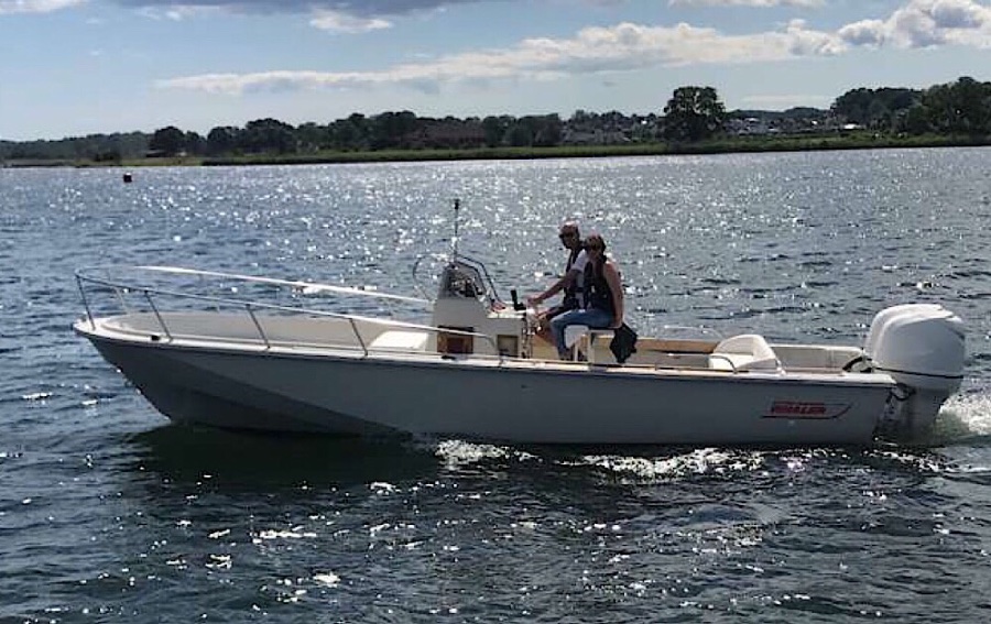

Don't know why the first picture ended up stretched and I don't know how to reduce picture size on iPad, which I needed for uploading here. Will try to upload some more pictures tomorrow.
Best regards Adrian
Best regards Adrian
- IMG_3383.JPG (146.28 KiB) Viewed 17830 times

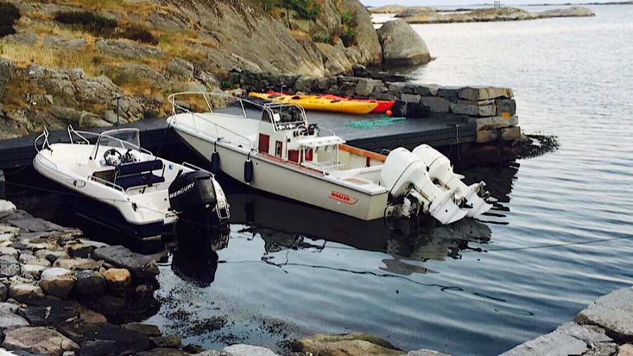

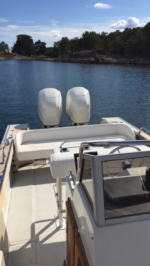

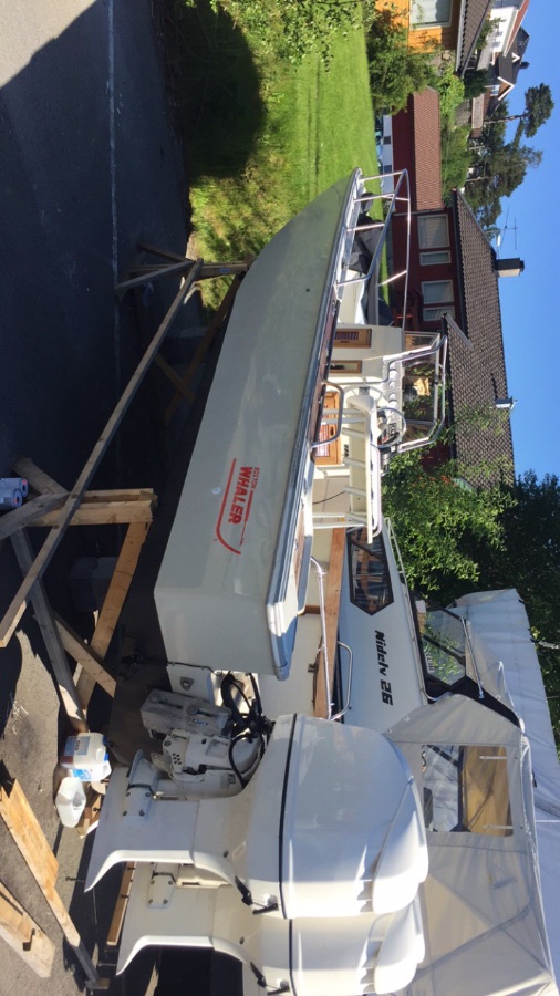

Typical load is 1/4-1/2 tank of fuel, 2 persons and approximately 250-300kg of gear, ice and ballast. Sometimes up to 8 persons and I plan to build a t-top for next season. Ocean conditions are mostly protected and less then 0,5m significant wave height. Longest trips are 110 nautical miles, but most trips are much shorter.
- IMG_0170.jpg (205.72 KiB) Viewed 17792 times
- IMG_0167.jpg (210.33 KiB) Viewed 17792 times
- IMG_0163.jpg (142.19 KiB) Viewed 17792 times
