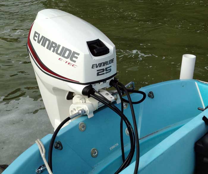

Do any of the four-stroke-cycle outboard engines you mention have the ability to run without needing a battery?
If that Yamaha 25-HP without power trim and tilt could do that, and I presume it might also be a pull-start engine, then you could eliminate the battery from the boat. That saves about 50 to 70-lbs of weight in the stern.
You can get a 25-HP E-TEC with short-shaft, rope starting, and no power trim. That would run without a battery.

jimh wrote:Do any of the four-stroke-cycle outboard engines you mention have the ability to run without needing a battery?

On 13-foot Boston Whaler hulls of early production that have a notched transom intended for use with outboard engines with a 15-inch-shaft height, the most effective way to reduce water splashing over the transom when the boat is coming off plane will be to raise the transom height to 20-inches and eliminate the notch. Boston Whaler changed the design of the 13-foot hull to have a 20-inch transom in c.1972.
A further problem with using a 15-inch-transom is the weight of modern outboard engines; they are heavier than the traditional outboard engines of the 1960's that were in use when the 13-foot hull was originally designed and produced. Although there are a few modern outboard engines still made with 15-inch shafts, those engines are heavier than a c.1960 outboard engine.
The most effective method of raising the transom height to 20-inches to eliminate splashing of water over the transom will require actually re-fabricating the transom with new embedded wood, new laminates, and new gel coat. Such a modification is complicated by the curved shape of the original transom.
Fig. 1. A 13-foot Boston Whaler boat with the original 15-inch notched transom reworked to be a 20-inch transom.
In this instance, the fiberglass work on the hull was done professionally with extremely good results.
Photo by the author.
