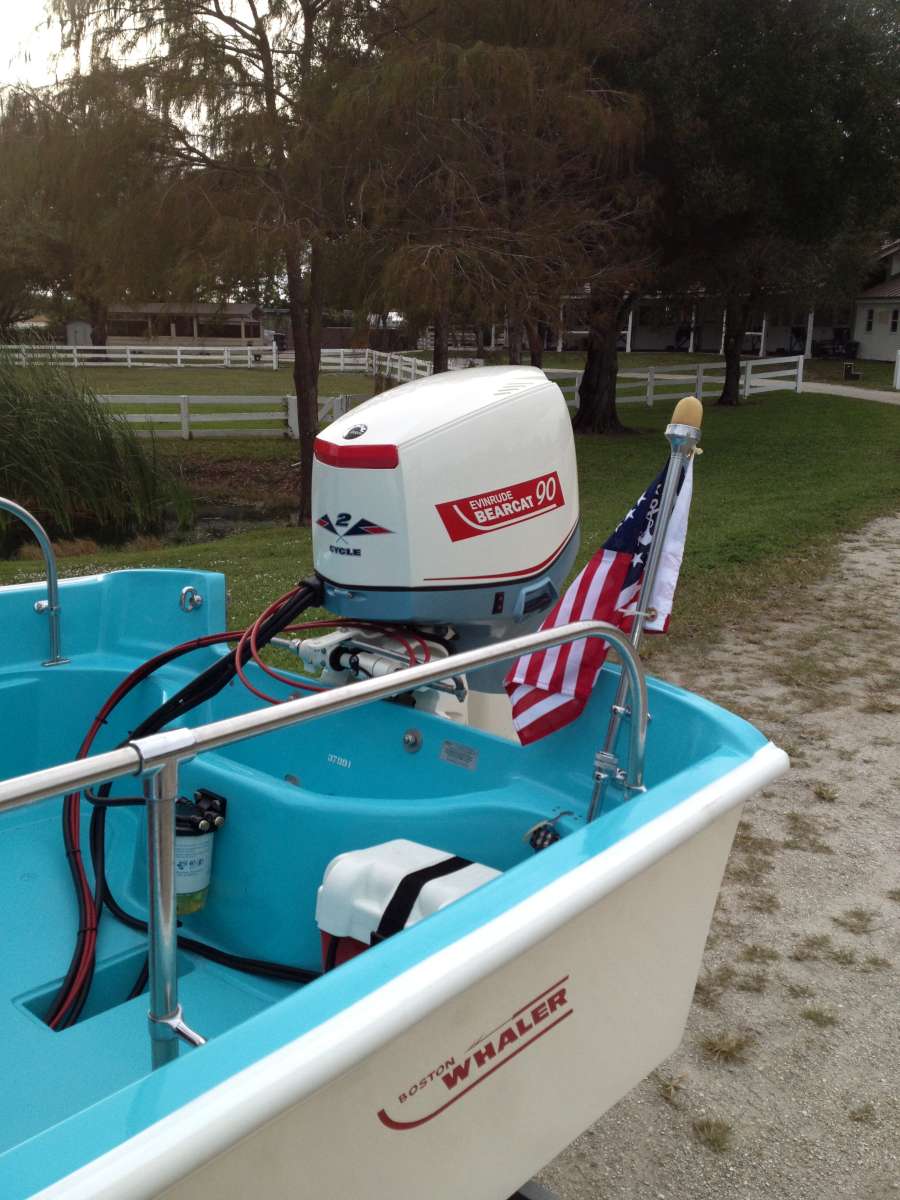

- DSCF9011-1200.jpg (74.76 KiB) Viewed 68286 times
Re: 1988 Montauk Evinrude Re-power
Thanks. That's my attempt at a year-2000 Bearcat. I think it works well with the classic blue and mahogany interior boats. I explained the details not long ago;

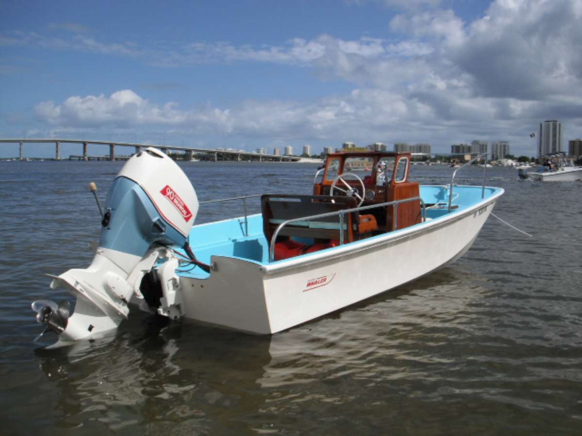

- 033-1200.jpg (113.15 KiB) Viewed 68230 times
