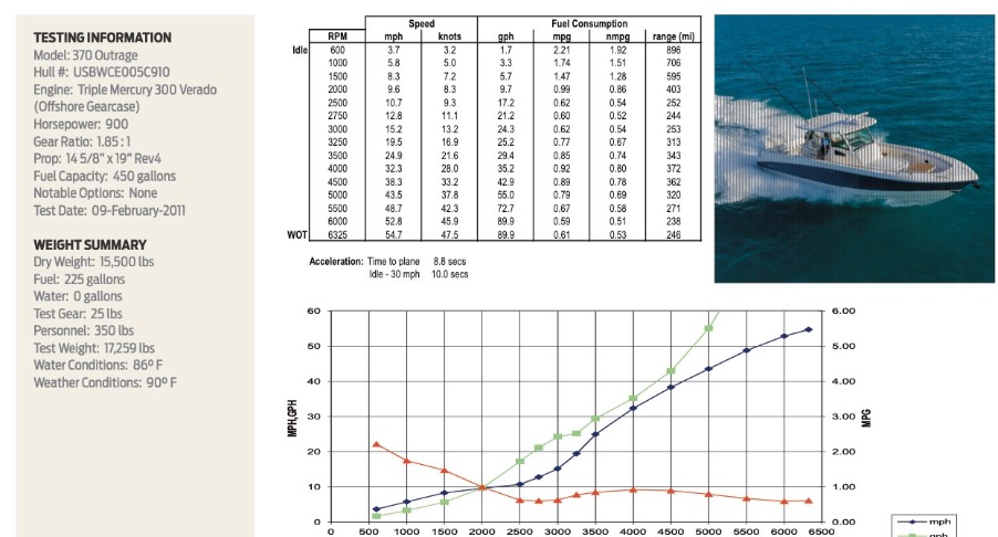

Hi guys, anymore update on this, I'm running a triple 300 verado on my 370 outrage equipped w/ REV4 19P and my GPH is very high, I use the boat for charters i'm checking how to reduce my GPH, change props to Enertia ECO or maybe tune the ECU to 350 to have more power ? Any help is welcome thanks.
Re: 370 OUTRAGE Fuel Economy
Postby Phil T » Mon Feb 21, 2022 4:31 pm
Jeremy -
Can you compare your fuel burn/rpm/speed to the chart below.

Tuning the ECU to increase engine HP is no longer easy. Simon Motorsports was one of the leading tuners but I believe the EPA has had a lot of success in shutting down tuners. If you can find 350 HP Verado ECUs to replace your original ECUs that may be your least cost option to increase your engines HP.
Postby Phil T » Tue Feb 22, 2022 10:30 am
Not sure how increasing HP of an engine that relies on supercharging is going to help fuel economy. If anything I would think it would result in worse economy.
