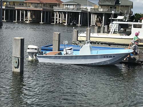

I have a 1971 16-footer which may be a NAUSET 16. It came with a 1986 Johnson 110. I feel like 110-HP is to much power and the engine too much weight for this boat. The boat is difficult to turn to port (I think).

Fig. 1. A pre-smirk 16-footer with OMC V4.

The boat was probably rated for 100-HP by Boston Whaler. The year of manufacture likely predates the Federal Boating Safety Act, so there may not be a required capacity plate on the hull.
Many 16-footers are powered with 70 to 90-HP ENGINES.
An Evinrude E-TEC 90 has been a popular choice.
A Yamaha F70B is another nice engine.
The OMC V4 you have now will run forever with proper care, routine maintenance, good oil, and clean fuel. And it is paid for.
When you see how much a new engine costs you may begin to like the one you have more.
ASIDE: the engine appears to be mounted on a set back bracket.
High steering force is often caused by poor engine trim.

Q4: from the photo, does it seem that the boat is sitting properly or is it too weighted in the rear?
The engine has a setback. I am curious as to why you pointed that out.
Q5: Should I take it off?

Engine is not too heavy. Set back bracket offsets the weight some and makes reversing a bit more difficult. Setback(jackplate) adds speed if set up correctly and allows for running in more shallow water.Many people have overpowered their 16/17's with 115hp or more. What Jim said is true about steering. If engine is all the way trimmed in, steering is usually difficult to port as the torque of the right hand propeller is fighting you. Besides mediocre fuel mileage, no need to repower unless you want to. You want to trim up(or out) at cruise until the wake flattens out so to speak. At WOT you want to trim it until it blows out(slips) and then bump it down until it grabs. Lastly you don't want to porpoise(unless you like getting sick) so trim down to stop it if it does happen. Usually those hulls do not porpoise too much like a 13 does.
As far as model is concerned, you have a 16' custom.

A4: Re the static trim as seen in Figure 1: the bow is probably higher than normal, probably due to the weight of the set back bracket added and to the increase in distance from the transom of the engine due to the bracket.
Re: 1971 16
Postby jimh » Wed Sep 25, 2019 1:45 pm
A5: Re removing the set back bracket: I don’t have a strong opinion on this question. I suspect the bracket is making the bow very light.
Without seeing how it has been set up in person, to tell if the bracket is set up properly will be difficult. Usually a bracket like that is used to raise the engine so the engine gear case and propeller can run in shallower water and also to reduce drag (in the expectation of more speed). Whether either outcome is realized is hard to know without before-and-after test data.
Also, the complaint about hard steering could be an artifact of poor rigging of the steering caused by the bracket mounting.
