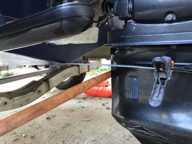

Fig. 5. The anti-ventilation plate position relative to the keel: they are level.
I could go up one-hole or two-holes higher and be consistent with Phil’s experience [of the anti-ventilation plate being above the keel by 1.5-inches]

As Figure 5 (above) shows, even at two-holes-up mounting the anti-ventilation plate of a SUZUKI DF90 is still just level with the hull keel.
I believe Nick remarked earlier that SUZUKI engines seem to need to be mounted higher than normal. Perhaps the SUZUKI notion of a particular shaft length is longer than other manufacturers, leading to the SUZUKI engine generally being mounted higher than one-hole-up or even two-holes-up to reach a effective engine mounting height.
If interested in further experimenting with engine mounting height, I suggest you try raising the engine. If you go to four-holes up, you can always easily lower the engine to three-holes-up if the propeller is not getting good thrust or if the engine cooling water pressure begins to falter.
