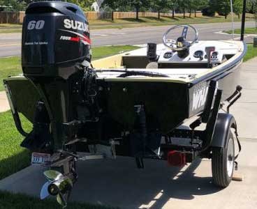

Fig. 1. stern.

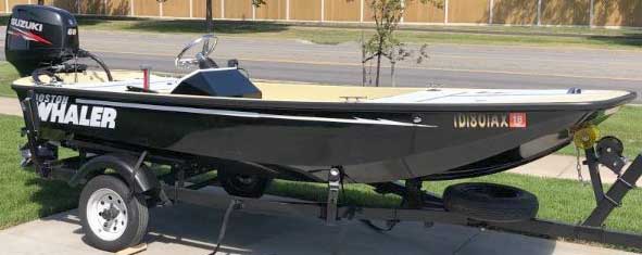

Fig. 2. starboard side.

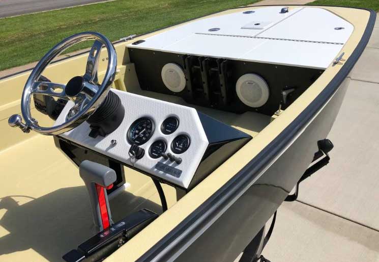

FIg. 3. modified interior.

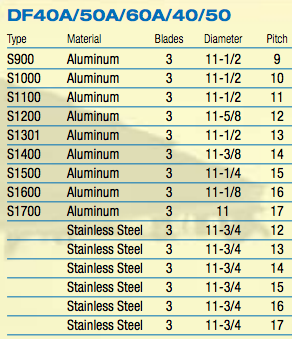

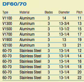

Q9: What is the maximum propeller diameter possible for a DF60a engine?
To answer my own question, I found this Suzuki propeller chart for the DF60 engine:
Fig. 4. Suzuki propeller chart
[UPDATE: while the above chart is accurate for the DF60, it is not accurate for the DF60a. See the appropriate chart below in a follow-up post, and ignore the advice that follows.]
It looks like a 14-inch diameter propeller can be used. On that basis, using a propeller with a 10.375-inch diameter seems very odd and very small diameter. Whoever made the choice of a 10.375-inch propeller likely did not appreciate the large propeller aperture on the Suzuki DF60a. The SMALLEST Suzuki propeller for this engine has a 13-inch diameter.
A more appropriate propeller might be the steel three-blade 16-pitch or 14-pitch, both 13-1/4-inch diameter or the aluminum 17-pitch or 15-pitch.

Zarati wrote:ASIDE: some views of the boat on a trailer.
The stern view in Figure 1 is so badly illuminated that no details of the engine mounting height or the trim tabs are visible. If you want to illustrate the engine mounting, produce an image with better lighting that more clearly shows the engine mounting height and the trim tab installation. The image you provided has the entire stern in deep shadow.
Also, with all the added weight in the bow, and with the hull having an intentional hook to limit bow rise, I am surprised that trim tabs were needed to keep the bow down during transition to plane or while running on plane.
Q10: where are the seats for four people? I only see in Figure 2 what appear to be one thwart seat across the cockpit at the helm.

jimh wrote:....looks like a 14-inch diameter propeller can be used...appropriate propeller might be the steel three-blade 16-pitch or 14-pitch, both 13-1/4-inch diameter or the aluminum 17-pitch or 15-pitch.
The engine is DF-60a, a lighter-weight version with a much smaller [gear case] than the DF60. The DF60a is the top of the 30 to 60-HP model line and the DF-60 is the bottom of the larger model line 60 to 70-HP, which uses a much larger propeller.
Thanks for [the link to the Suzuki propeller catalouge] which shows the DF-60a has a range of 11.125 to [11.75-inches].
[Below I added the more appropriate chart for the DF-60a propeller choices--jimh]
Suzuki propeller chart for DF-60a
A9: 11 3/8 to [11.75]-inches. The DF60 uses larger propellers. DF60a (which is what I have) uses smaller propellers.

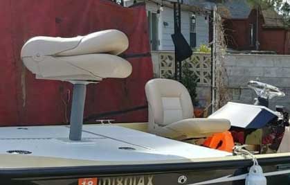

A10: the boat has a swing out seat bracket that folds out of the way. One seat is in front of console. Another is in its forward position but can also be mounted on the port side in the same location.
Fold out seat on starboard, with another seat on bow platform.

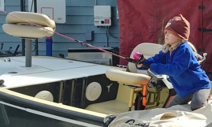

Forward seating on modified 13-footer

I apologize for the confusion in the propeller aperture diameter. I didn't see the separate listing of propellers for the DF60a model. Now going back to the first question in this thread:
Zarati wrote:Q1: will a different four-blade propeller with more [blade] area [produce the improvement in boat speed desired]?
With the notion that actual maximum propeller diameter for the DF60a engine is about 11.75-inches, the present propeller with 10.375-inch diameter now seems more appropriate, but there is still another 1.375-inch increase in diameter possible. Using a larger diameter propeller should tend to reduce the SLIP factor, which (as calculated from your data) was abnormally high at 20-percent SLIP.
