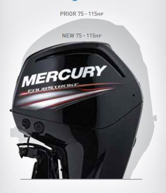

- Capture.JPG (22.29 KiB) Viewed 21736 times
Member since 2005
Re: Engine Choice in 115-HP
I love that size comparison image. That is a wonderful demonstration of the reduced engine size of the new model 115 FOURSTROKE BASED ON 2.1-LITER BLOCK compared to the 115 FOURSTROKE BASED ON 1.7-LITER BLOCK model.

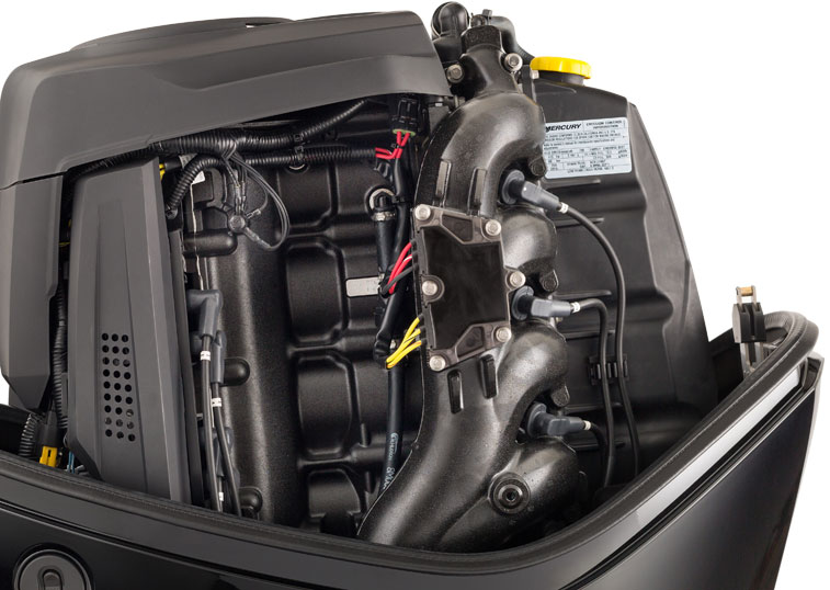

I am not sure how long the reviewer has been dozing in Sleepy Hollow, but engines with a distributor-less spark ignition system have had individual spark coils for each cylinder for perhaps 40-years, say from c.1975. This is not something particularly indicative of an advancement in engine design. (Cf.: https://en.wikipedia.org/wiki/Distribut ... t_ignition ) But these are shortcomings in the review, not in the engine.
Three of the individual spark coils are seen in this view. They appear to be the coil-on-plug type.
I am also curious about the function of the trapezoidal electrical assembly mounted to the exhaust manifold. It appears to have six electrical conductors attached to it. Has anyone an idea what that device might be?
By the way, my best guess about the function of the device is it's a rectifier.
