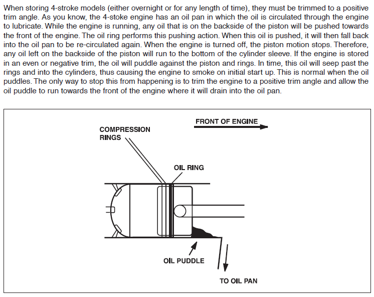

Is [the smoke puff for a duration of three to four seconds during engine starting due to] the fuel enrichment adding more gasoline? I thought only carburetor engines did that.

FISHNFF wrote:Is [the smoke puff for a duration of three to four seconds during engine starting due to] the fuel enrichment adding more gasoline? I thought only carburetor engines did that.FISHNFF
An EFI motor will also enrichen the fuel mixture during a cold start, similar to what a carburetor model will do, but I don't think this is your problem. Excessive fuel will be blackish smoke. Excessive oil will be bluish smoke.
If a four stroke is left trimmed down then over time a bit of oil will migrate past the piston rings and get into the combustion chamber. The motor will then emit puff(s) of smoke when next started. To see if this is the situation with your motor try trimming the motor up a bit when it is not being used. See if this mitigates the smoking concern.

Thanks for the oil seepage remarks. I don't think they applies because the smoke will occur each and every time I start the motor, whether it sits ten seconds, ten minutes, or ten days. And the smoke does not look blue. And it is not steam.
I am inclined to think it is a little extra shot of fuel is the cause. Not a big concern, just an observation. I'll check with the dealer.

ALLOY--that is a very interesting observation regarding oil getting into the combustion chamber based on the orientation of the engine after shut down. Thanks for that information.
