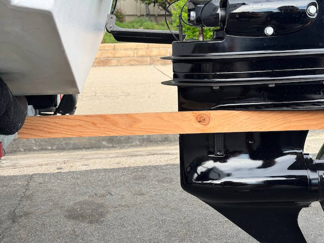

I may make a change to the engine mounting height and the propeller used on a SUZUKI DF140 on a GUARDIAN 19, shown below in Figure 1.
Fig. 1. The relationship between the anti-ventilation plate and the hull keel is shown. The anti-ventilation plate is located far below the hull keel, although no actual measurement of the distance is possible to deduce from this photograph.
Engine Height.jpg (51.28 KiB) Viewed 17713 times
Q1: how much influence on performance does engine mounting height have?
Q2: how much influence does a propeller have on performance?

Among information about engine mounting height that I have read, my impression is that a common though is to have the bottom cavitation plate should be level with the bottom of the keel.

The hydrofoil on the engine gear case is the Anti-Ventilation plate. Its purpose is to prevent the ventilation of the propeller.
Cavitation occurs at the blade edges and is NOT prevented by the anti-ventilation plate. Many boaters confuse the terms ventilation and cavitation. For more help in understanding what propeller ventilation and propeller blade cavitation are, read at
https://boattest.com/article/propeller- ... difference
pcloward wrote:...my impression is that a common though is to have the bottom cavitation plate should be level with the bottom of the keel.
Your impression of what is commonly thought is quite different from what is commonly thought on this forum.
On this forum the common thought about engine mounting height is that when the boat is operating at speed and on plane and the engine trim is set so the anti-ventilation plate is level with the water, the anti-ventilation plate should be running just at or just above the flow of water that is traveling across the anti-ventilation plate.
You can see some samples of A-V Plates that are running close to or at or above the flow of water when the boat is on plane at
A-V Plate Photographs
https://continuouswave.com/forum/viewto ... f=7&t=8605

pcloward wrote:Q1: how much influence on performance does engine mounting height have?
Engine mounting height has an effect on boat performance, primarily by reducing the volume of the submerged portion of the engine and therefore reducing the drag induced by that volume. Exactly how to quantify the amount of influence is difficult so only a general answer can be given to your question.

pcloward--The anti-ventilation plate should be 1-1/2 to 2-inches above the bottom of the keel.

When photographing the relationship between the A-V plate and the water flow around the gear case, the boat should be on plane at a typical speed where it cruises nicely, and the boat speed does not have to be the maximum possible boat speed. The engine should be properly trimmed, which means the propeller shaft should be parallel with the water surface, and the A-V plate will then also be parallel to the water surface.
If the gear case and A-V plate are painted white, seeing the plate in foamy water can be difficult, so black tape could temporarily be applied to the upper surface of the A-V plate to enhance the contrast between foamy water and spray and the plate itself.
Trying to take photographs of the A-V plate at very high boat speed could be dangerous.
