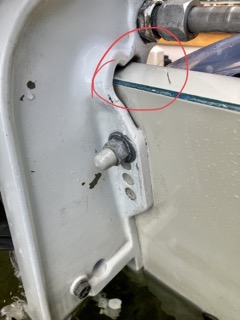

My 1985 Johnson 70-HP engine is presently mounted on the transom of my 1985 SUPER SPORT 15 in the lowest possible position. The upper engine mounting holes are drilled in the transom about 1.75-inches below the top of the notched transom.
Fig. 1. Engine mounting position on transom of 1985 SUPER SPORT 15, made more difficult to see by a red line scribble.
IMG_4180 Small.jpeg (20.8 KiB) Viewed 14367 times
Q1: will raising the engine mounting height [from lowest possible to one-hole-up or two-holes up] improve [the top speed] performance of the boat?
Q2: when an engine is raised above the lowest possible engine mounting position, it is proper that some part of the engine mount [that appears to have been designed to rest on the top surface of transom] to be then above the transom top surface?

davidB01 wrote:Q1: will raising the engine mounting height [from lowest possible to one-hole-up or two-holes up] improve the top speed performance of the boat?
Yes, up to the point that raising the engine any farther causes reduction in cooling water flow or pressure and also creates a tendency for the propeller to ventilate.
davidB01 wrote:Q2: when an engine is raised above the lowest possible engine mounting position, it is proper that some part of the engine mount [that appears to have been designed to rest on the top surface of transom] to be then above the transom top surface?
Yes. The only engines which are designed to sit on the transom with their mounting bracket resting on the upper surface of the transom are those smaller and lower horsepower engines which use a hand-operated clamps to secure the engine to the transom. Once the engine is secured to the transom by four large mounting bolts, there is no concern that the lip of the engine bracket is no longer resting on the transom--if it ever was when it was in the lowest engine height position.

davidB01 wrote:The upper engine mounting holes are drilled in the transom about 1.75-inches below the top of the notched transom.
Your are in luck--that is the proper location. For more details of where the engine mounting holes should be drilled in the transom, read the article at
Transom Mounting Hole Layout for Shallow Splash Well
https://continuouswave.com/forum/viewto ... f=7&t=5808
IMPORTANT--the classic 15-foot hull has a shallow engine splash well. You should read the above article carefully to learn about options for where the engine mounting holes can be located on the transom in order to avoid the shallow engine splash well problem.
You illustration of the engine mounting of your SUPER SPORT 15 boat seen in Figure 1, above, does not show the lower engine mounting bolt location. You need to investigate where the lower engine mounting bolts are located and if they are visible in the engine splash well of the 15-footer.

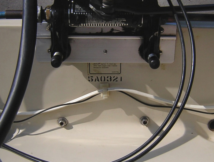

ASIDE: I think the use of a slot for the lower engine mounting bolts is to make it easier for the installer. With a fixed hole position for both the upper and lower mounting bolt location on the engine bracket, the installer must use very good accuracy when drilling the bottom holes at the proper spacing. With a slot there can be a lot of slop in the lower hole position. It was (and maybe still is) NORMAL that when drilling the engine mounting holes in the transom a metal template was used so the installed couldn't make a mistake in where the holes were to be drilled and also on the proper right-angle (square to the transom). Using a template was the norm, at least at an OMC dealership that knew what they were doing.
ASIDE: as I recall, on my 1976 SPORT 15 the lower engine bolt mounting holes were drilled on an upward angle, and there was an interference fit of the bolt head to engine mounting bracket and also for the retaining nut at the transom where is was just above the bottom of the splash well. Also, the diameter of that hole was smaller than the usual size employed for mounting modern engines, as it was just a 1/4-inch bolt as I recall.
Fig. 2. Lower engine mounting bolt position on inboard side of transom of 1976 SPORT 15, just clearing above the splash well bottom due having the hole drilled on an upward angle from the outboard side of the transom.
