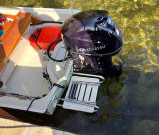

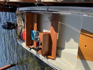

Postby davidB01 » Sat Oct 19, 2024 9:13 am
I got the new 60-HP Tohatsu 60-HP four-stroke-power-cycle engine installed on my 1985 SUPER SPORT 15. Dave Rossetti and his apprentice Doug of Lighthouse Marine in Tuftonboro, New Hampshire, did a great job in the engine installation, in cleaning up the space behind the main bench seat with moving the battery into the storage box, in deleting the oil pump, rerouting the cables and wires, and cleaning up the gel coat and old mounting holes. My spouse--for whom the boat is being configured--is very happy.
Fig. 2. The new Tohatsu 60-HP engine on the SUPER SPORT 15.
Fig. 3. Clean aft cockpit deck and transom with swim platform on Port.
PERFORMANCE DATA
From sea trials on an a flat lake, the boat was able accelerate to 43-MPH with the 60-HP Tohatsu engine, mounted three-holes-up, with a 15-pitch propeller, and trimmed up as high as I dared (at this point). The engine speed indicated on the new tachometer was about 6,000-RPM, which occurred just before the first warning buzzer from the engine.
Using Jim’s Crouch’s calculator with inputs
    HP=60
    MPH = 43
    HULL COEFFICENT =190
the calculated boat weight is 1,070-lbs.
I estimate the actual boat weight as follows (all in lbs):
    Base hull = 525
    Tohatsu engine = 216
    Crew weight = 195
    Battery = 35
    Six gallons fuel and tank = 40
    Swim platform = 20
    Stuff = 30
    TOTAL = 1061-lbs
The two estimates (1,070-lbs and 1,061-lbs) are close, so I think the weight is just about correct as deduced from the performance data.
My mechanic, Dave, noted that the propeller pitch should be increased to 16-pitch to stay within the Tohatsu engine speed guidelines, and the larger pitch might produced a small increase in boat speed, but that would come at the expense of acceleration. [With the 15-pitch propeller] the boat does nicely get up and go from a standing start.
The installers and I also noted that with the actual length of the shaft of this engine at 21.4-inches the engine mounting height could be raised one-hole higher--if I wanted. I have not had a chance yet to see where we the Anti-Ventilaton plate is sitting at full speed.

Re: 1985 Super Sport 15 60-HP Re-power
Postby jimh » Mon Oct 21, 2024 10:03 am
Getting 43-MPH from the 60-HP engine on the SUPER SPORT 15 sounds very good. I think you are well configured.
Adding an inch of pitch should pull down the engine speed by at least 200-RPM (using an old rule of thumb). But boats always seem to get heavier as they get used, as more people and more stuff comes aboard.

This aspect of the project is now complete. I still need to work on the wood, but we have a nice, reliable, fun boat in the family fleet now.
Thank you all (and especially JimH) for all your advice during this journey. Learned a ton.

To all: My Tohatsu is the MFS60A. Now through the break-in period, and it is performing to all my expectations. Also, very easy to self-service for oil and fluid changes. Running Aviation gas (more stable than even non-ethanol fuel) through it to help eliminate winter storage problems.
We did find a very slight interference between the Martin swim platform and the Tohatsu 60 when turned over to the steering stop and the engine all the way down.This is due to the styling curve of the top section to lower unit. I am not sure we could have pushed the Martin platform any further outboard and still have Martin’s outboard-most special upper mount screw still work. Have found 4 solutions. A) just being careful at idle speeds not to go all the way to the stop (not a problem at normal operation as we don’t turn it that far while running), b) trim the engine up to 25%, which eliminates the concern due to the slope of the design curve (and is still absolutely fine popping up onto a plane), c) before installing the the Martin platform, bend the inside top rail about an inch outboard (really did not want to disturb Ray Martin’s work like this, or d) if a jack plate was in place, even a 4 inch one, it would not happen with the engine that much further aft relative to the end of the swim platform.
Having looked at Chuck Anderson’s 15 SS before we installed and taking measurements to match his, we did not expect this, but he has a Y70 on a jackplate. Right now, A) and B) are working fine as a solution. As we have the platform on the port side of the boat, I am trying to find a “stop” I can add at the end of the steering arm to eliminate the chance of it happening. If I was mounting the engine again, would add a jackplate, not only for this, but for other reasons as well.
If anyone wants more information on this, please reach out to me directly. Happy to help.
